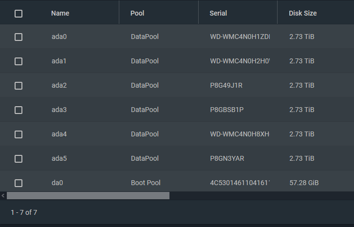

Hi all. I have some experience using RAID controls on Linux systems but am new to FreeNAS. This week I installed FreeNAS-11.3-U4.1 on an old spare machine, put three 3TB drives in it and created a storage pool. A couple days later, I added three more 3TB drives, for a total of 6x3TB drives. I used the extend option on the pool to add the additional three, so now I have two RAIDZ1 entries for the six drives.
My question is on the total capacity - FreeNAS shows the data pool as healthy with 3.73 TB used and 6.75 TB available, for a total just over 10 TB. I thought that number should be closer to 15 TiB. Did I go wrong with my math or the configuration? Thanks.

Could I have added the additional three drives to the existing group to increase capacity?
Unfortunately not. Your pool consists of two virtual devices (vdevs), each a three-disk RAIDZ1 vdev. A current limitation of ZFS is that you cannot add to, or remove disks from, a vdev. You can only grow a pool by adding an additional vdev to it (as you've done) or replacing all the disks in a vdev with larger capacity disks.
If this is a new installation, I suggest you rebuild the pool using a single six-disk RAIDZ2 vdev. Your usable space will remain the same at around 10.4 TiB. The difference is reliability. With your current arrangement, if you lose two disks in one of the RAIDZ1 vdevs, you will lose the entire pool, whereas if you lose two disks in the RAIDZ2 vdev, the pool will continue to function, albeit in a degraded state.
