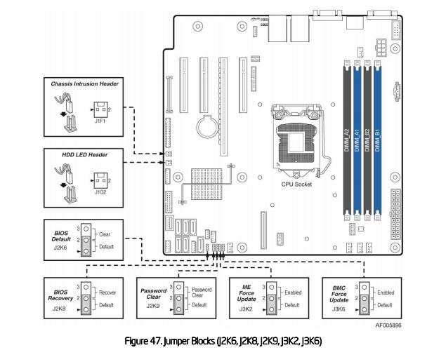

How did you clear CMOS? According to the manual, p. 202-203, you need to access jumper J2K6
and use the procedure in block 10.1:
10.1 BIOS Default Jumper Block
  1. This jumper resets BIOS Setup options to their default factory settings.
  2. Power down the server and unplug the power cords.
  3. Open the chassis and remove the Riser #2 assembly.
  4. Move BIOS DFLT jumper from the default (pins 1 and 2) position to the Set BIOS Defaults position (pins 2 and 3).
  5. Wait 5 seconds then move the jumper back to the default position of pins 1 and 2.
  6. Install riser card assembly.
  7. Install Power Cords.
  8. Power on system.
    Note: BIOS Error Manager should report a 5220 error code (BIOS Settings reset to default settings).
You really should consult the manual yourself, as this is a problem specific to your motherboard, and not a TrueNAS issue.

Check to see if there is access through the serial port, via IME, or via BMC. Intel has historically been really good about making their devices accessible in the data center. The jumpers above suggest both IME and BMC are potentially available.

It looks like there is a serial (DE-9) and VGA (DE-15) port on the back panel, based on the picture above. If you were to connect a terminal up to the serial port, it is possible that when you boot the system, it will mirror the console output to the serial (which is how you can tell if this is a useful option), and if so, it is also listening for keystrokes on the serial port. You can do this by connecting another PC to it using a terminal software package. Try common speeds of 9600, 57600, and 115200 bps, and make sure to disable hardware handshaking.
Historically, this is how some Intel systems such as the ISP1100 were commonly deployed at data centers, and serial management is one of the reasons some server lines still keep a serial port around.
You can also check the manual to see what is available for the IME subsystem (these usually need to be configured) and the BMC (more likely to auto-configure itself via DHCP), and whether you can get console access through these.
At the end of the day, I would be stunned if Intel didn't offer several ways for you to get into the thing.
