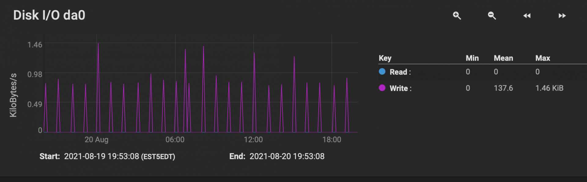

Jun 2, 2019
590
Sure, but my experience with those is that they're not notably faster than the USB thumb drives I'm using.
It's not about speed for the boot drive, it's about longevity. Consumer USB flash drives just don't survive repeated writes.
The Crucial X8 is a M.2 SSD in a USB3 enclosure. I found out it's QLC flash, which is why I switched to a SLC eUSB DOM for better wear durability. The eUSB DOM is only rated for 34 MB/s read, 22 MB/s write. It doesn't need to be any faster. It's just a boot drive, writing some system logs. A few KB/s every now any then.
