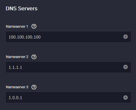

I needed to add the `100.100.100.100` magic dns IP from Tailscale in order to expose my Kubernetes applications.
Network > Edit Interface > DNS Servers

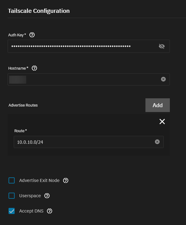

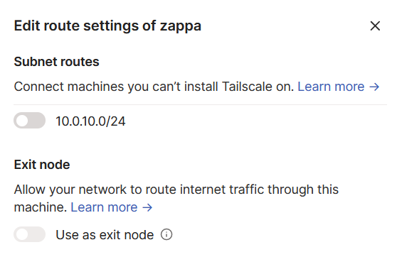

I had to remove the subnet route on Tailscale since both my servers were conflicting each other.
Tailscale Admin > Machines > Edit route settings

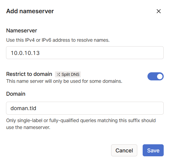

Then I needed to add both of my server's ip as nameservers and restrict those to my custom ingress domain.
Tailscale Admin > DNS > Add nameserver > Custom

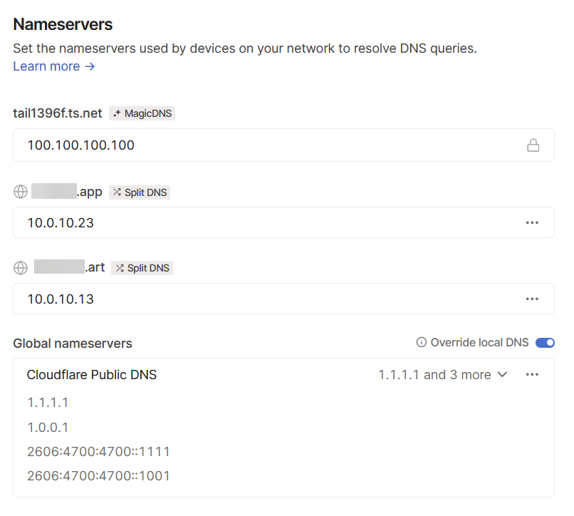

It should look like this once setup. Basically magic dns will check if the request is for one of your domains and send the traffic to the right server IP, then your DNS server (Blocky from Truecharts in my case) will forward the request to Traefik and resolve the sub.domain.tld request. If the request is for a different domain than the ones configured on your servers it'll send them to Cloudflare or whatever public dns server you've setup.
I really like this method of installing Tailscale on my clients since I don't have to modify the DNS server anymore on my PC and phone and if I reboot the server I don't lose internet anymore.

Actually tried outside of my home network and if the routes are disabled you can't access the apps. So if you got 2 servers on the same vlan it's conflicting. Hopefully my second server is going at a remote site and will be on 192.168.x.x so that should fix it for me.
