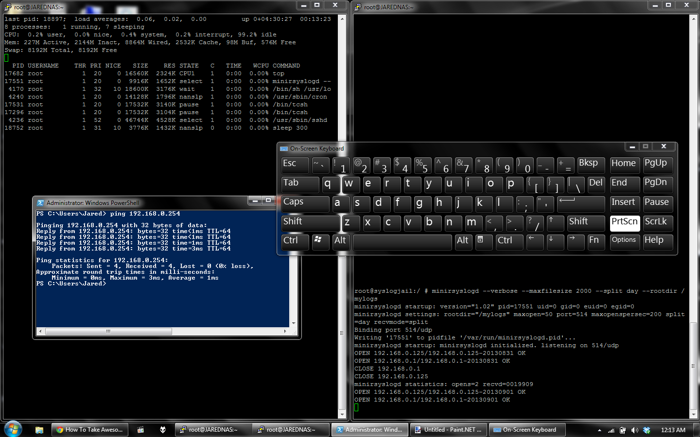

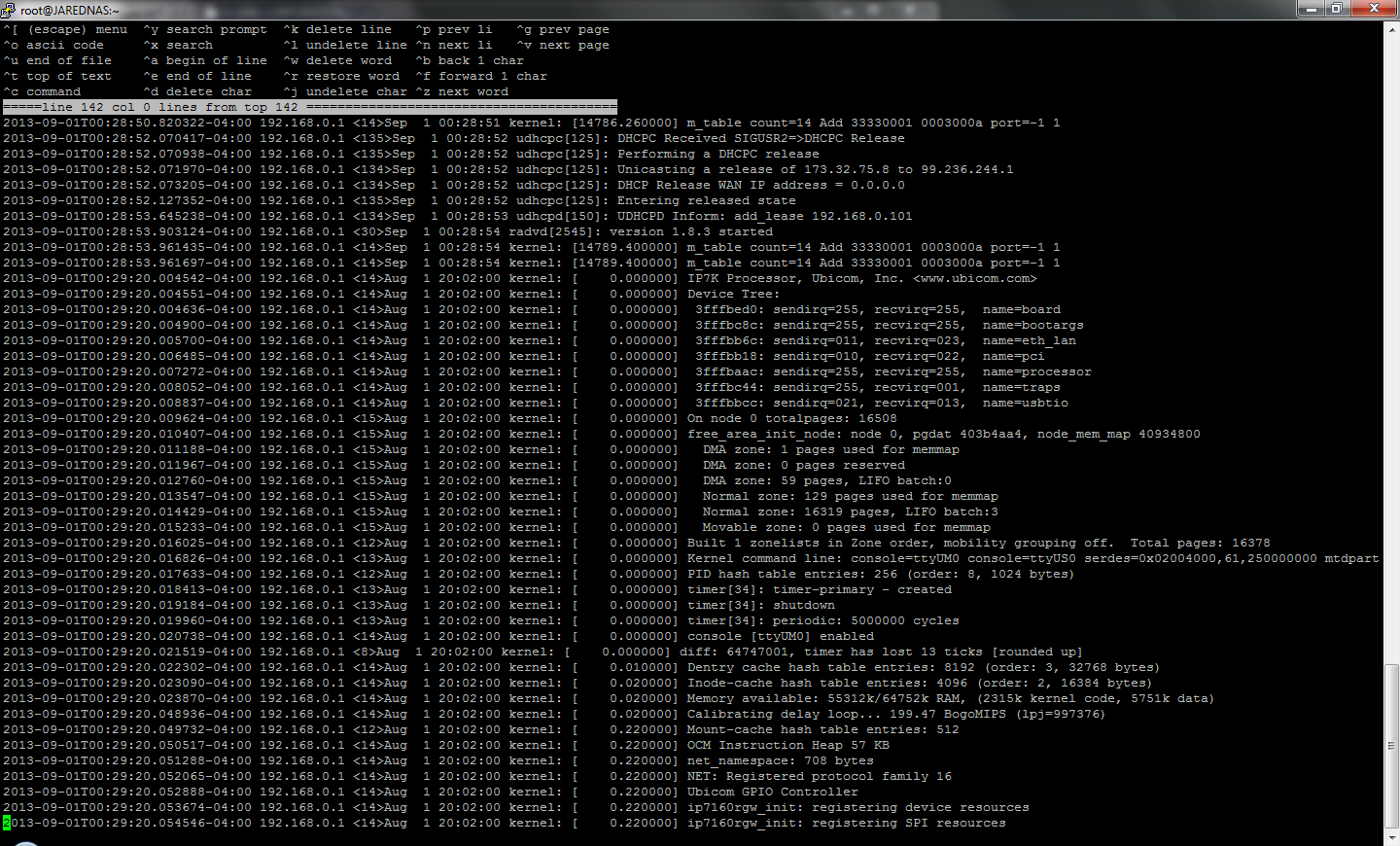

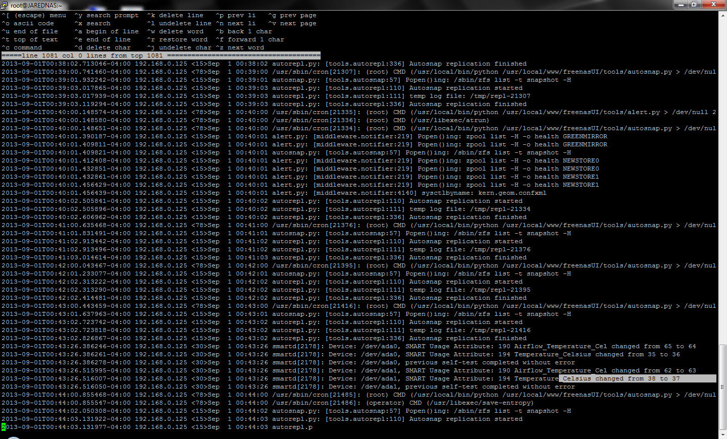

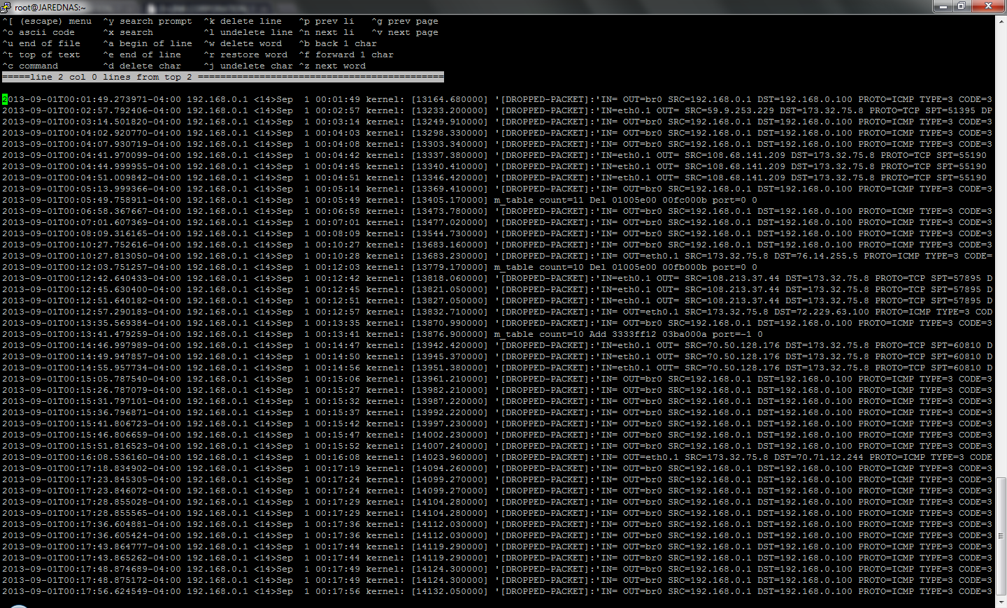

The only thing left now is to have the daemon startup with appropriate "options" on startup (there is no config file) . I probably could of made syslogd do remote collecting but it looked complicated.. I just wanted to add a package and use it.. Been successful so far..
Might have to do some reading on rc & init and set something up for the jail..
I didn't want to have a syslog server on a client pc so I really wanted to use freenas / jail and some packaged software.. Seems sucessful so far..

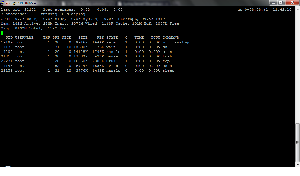

Top from jail #2.. Should I be worried about high PID count?

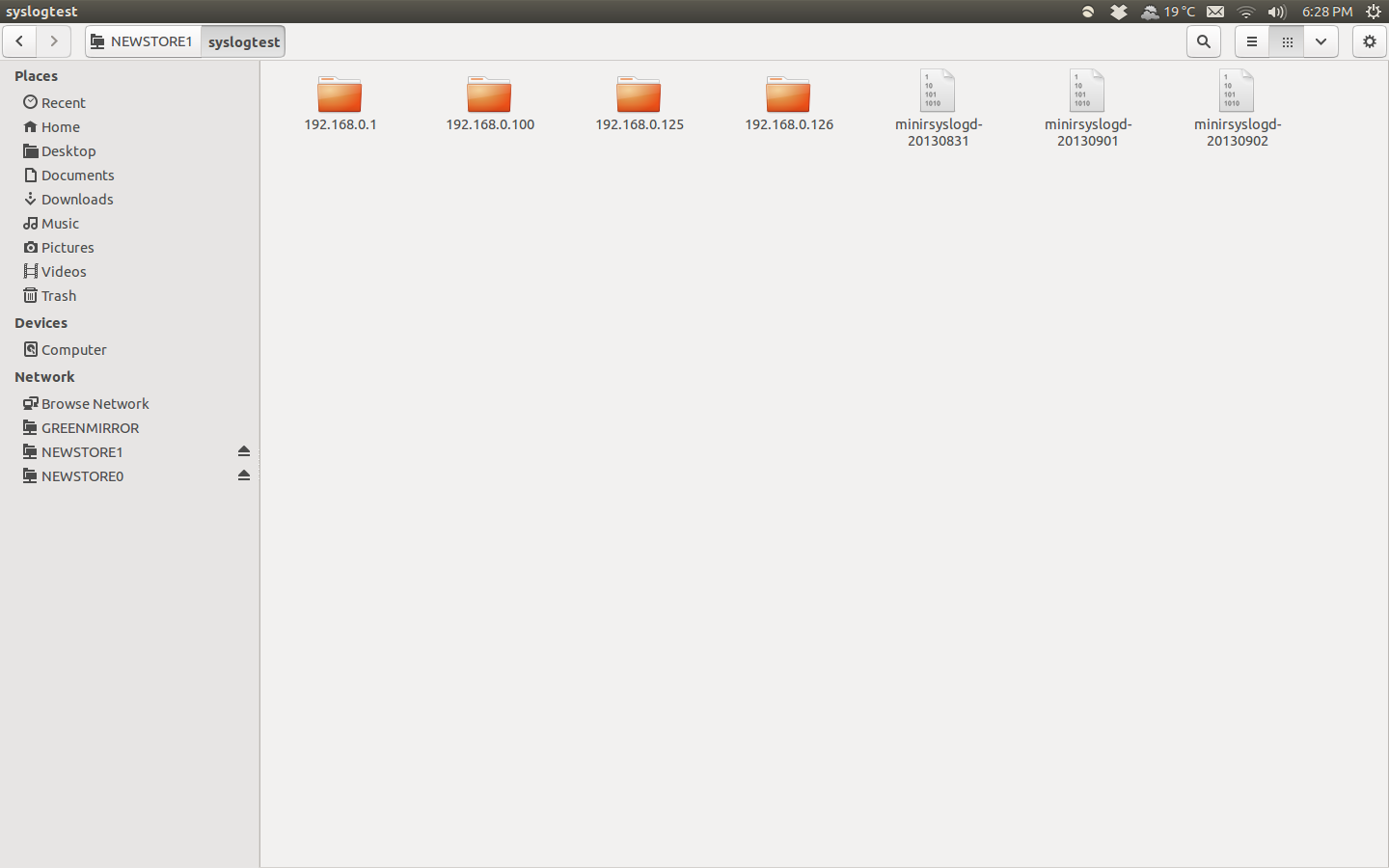

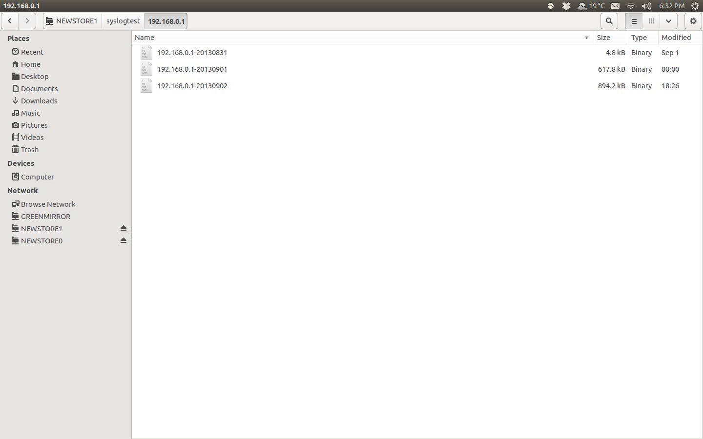

I like the structure though..
  • Screenshot from 2013-09-02 18:28:50.png
  • Screenshot from 2013-09-02 18:32:54.png
