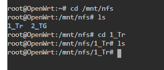

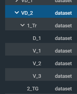

I mount an NFS shared folder on another LINUX and can only access one level of directories.
