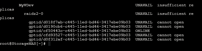

I have gotten as far as creating a storage pool, creating a share, and successfully being able to map that share on a windows box. My trouble comes when I go to reboot the machine through either the CLI or through the shell. Once it boots back up, my pool shows as Offline. Attached is the zpool import command:
There is no data on the drives yet, so I have been recreating it each time, only to find out that every time it turns off or reboots the pool goes offline again. I understand there may be a way to import it again, but how can I fix the pool disappearing?

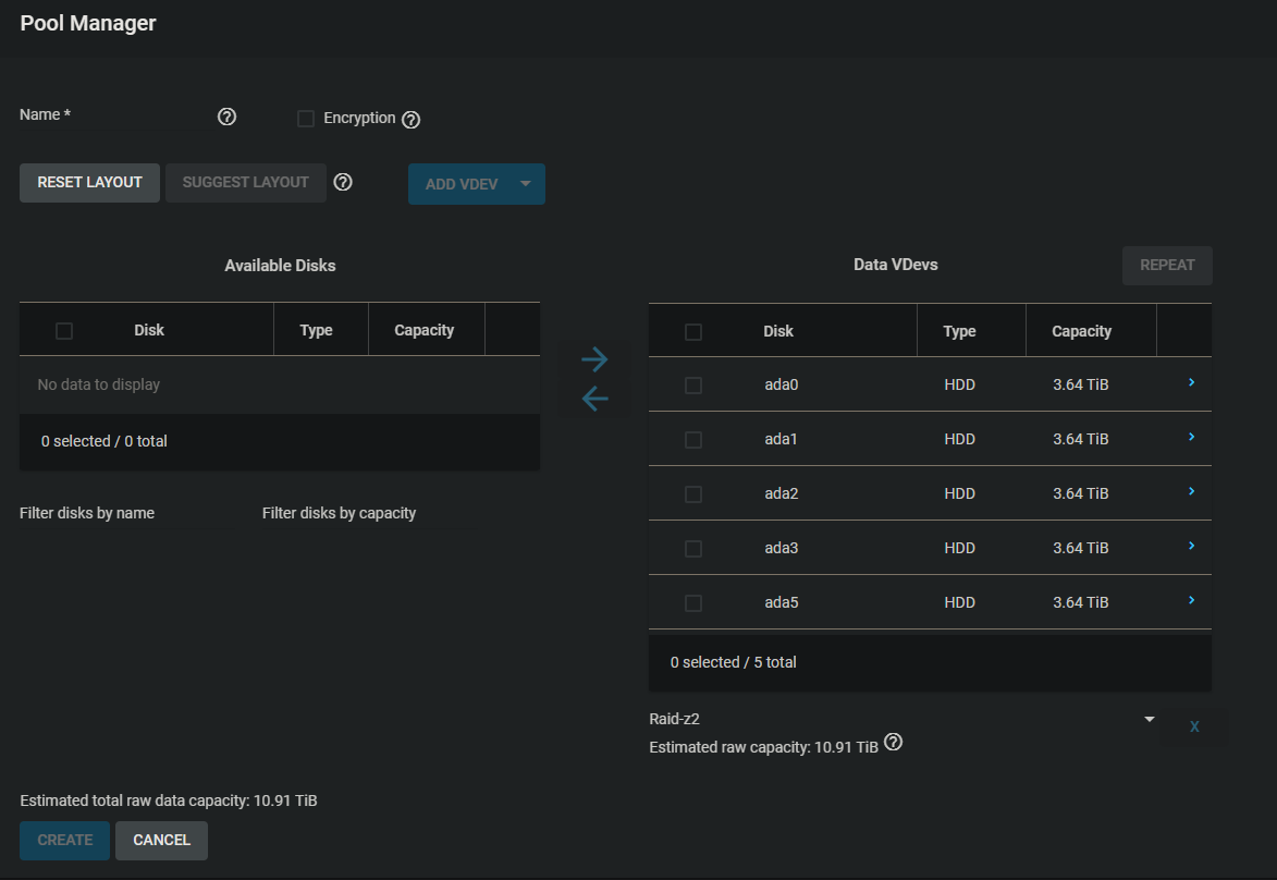

1. How are you creating the pool?

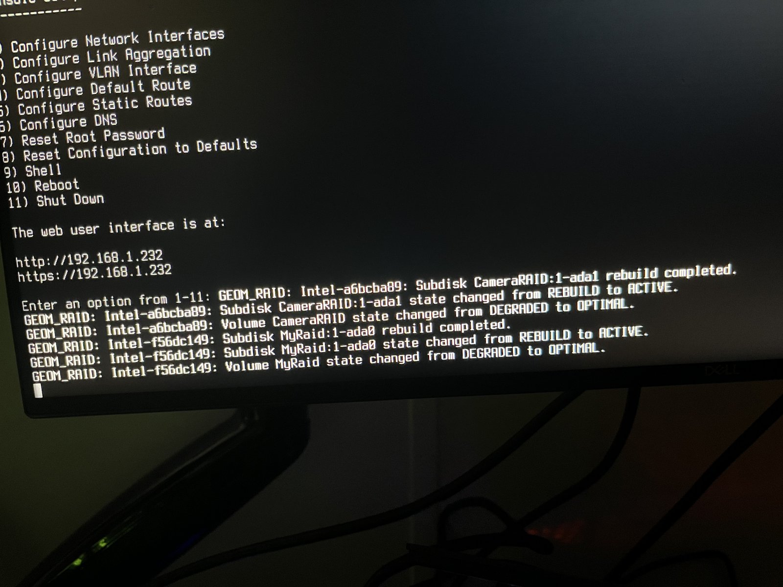

Hello everyone, here's something I noticed on my main console. It appears that my previous Dell raids (MyRaid and CameraRaid) from 4 of the 5 drives is still trying to do something? I thought if I wiped the drives it would disappear.

Hello everyone, here's something I noticed on my main console. It appears that my previous Dell raids (MyRaid and CameraRaid) from 4 of the 5 drives is still trying to do something? I thought if I wiped the drives it would disappear. View attachment 64804
Just for clarity - "CameraRAID" and "MyRaid" are the names of hardware-based RAID volumes you created from a Dell RAID controller or through the Dell BIOS, and they're still trying to show up here in TrueNAS?
You might need to more aggressively wipe the disks if that's the case.

I thought GEOM_RAID was FreeBSD software RAID:
That is something we don't use today. In the early days, FreeBSD software RAID with UFS was an option for FreeNAS. Not any more. ZFS has all the features and more.
From those console readings, I would guess that the software RAID is rebuilding causing the disks to be un-available. It might even be corrupting your ZFS pool.
I don't understand how this setup is configured, as I don't know FreeBSD's software RAID. Thus, I can't help further.
Yes. From the console it looked like it was rebuilding them at the hardware level even when I wiped them. I put them back into the Dell's they came from and deleted the raid, then reinstalled them into the nas. All 4 of those drives were very hot--probably from the constant rebuilding.. It appears that doing that fixed the issue. I am a forehead.
