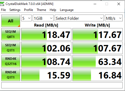

This is the speed test that I am getting with CrystalDiskMark
If I was to update Pc Nic card to a spf+ + add a mikrotik with spf+ ports + add spf+ card in server (or even upgrade the server if I can figure out my issues with R730xd that is not deployed yet https://www.truenas.com/community/threads/r730xd-issues-questions.88033/ , what improvement on speeds do you expect I will see with this spinning drives. I'm using WD 3TB red x 6 and most likely raidz2
the R730xd journey been a frustrating one so far (though I learned a lot and that was part of the goal) so not sure if I should sell it and get a supermicro or what.

If this is the only workstation doing the editing (and the T410 is physically close enough) you could just do a point-to-point link using a pair of 10GbE cards (Intel X520 is okay, Chelsio T520 is better, I've heard some people have luck with Mellanox cards) and a short SFP-DAC copper cable. Saves you the cost of the switch and the optical SFP+ modules.
I would say with a six-drive assumed Z2 you'd at the very least be doubling your sequential read/write speeds, more likely getting around 300MB/s. It will depend on how full your pool is and how fragmented the free space is as well.
