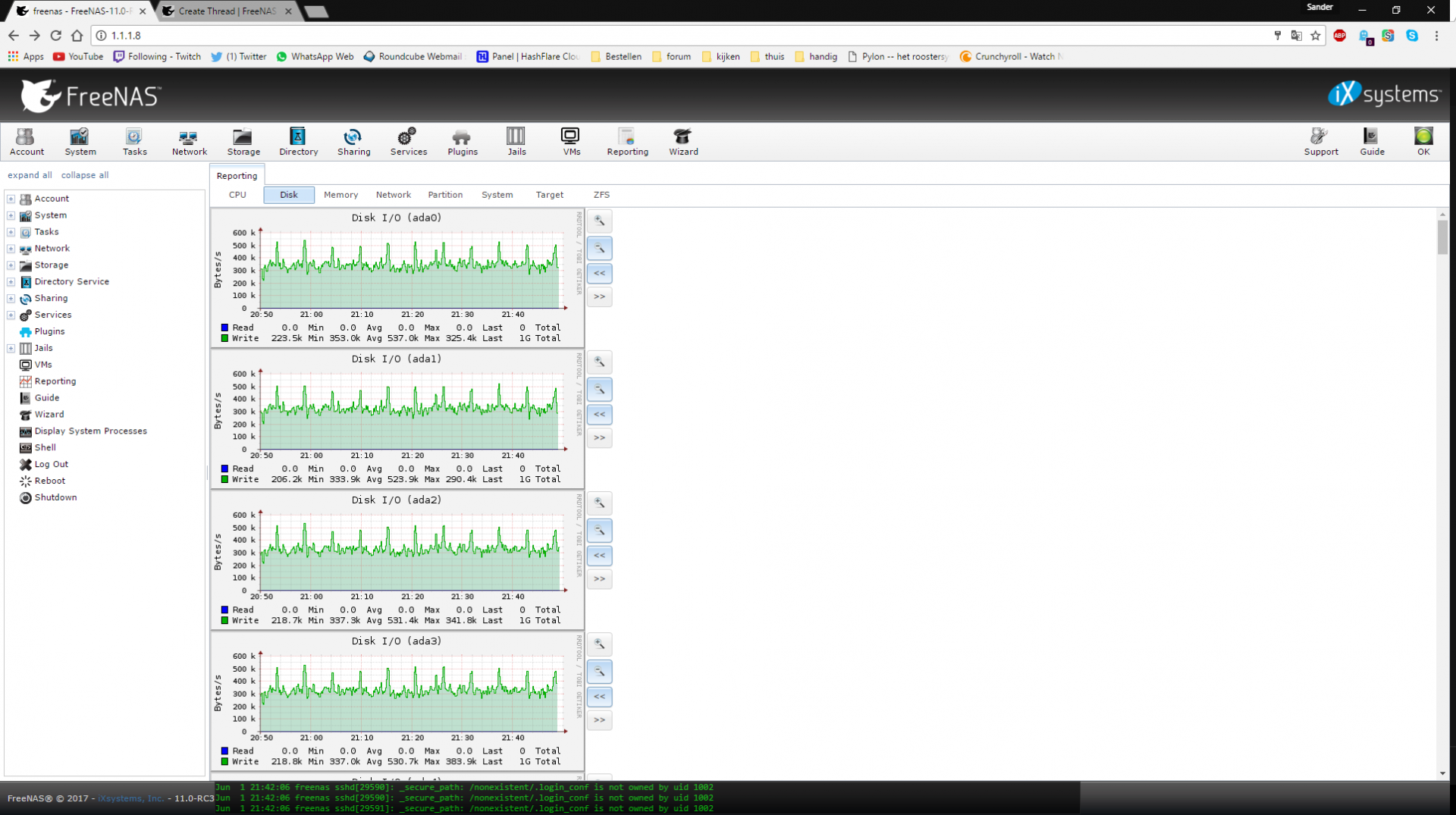

hey,
I would like to set freenas to spindown drives that are idle. Ive set it in the disk overvieuw and it seems to save it. Funny thing is that non of my disks are actually ever idle. there is a constant 300kib writhing. I have no idea where this is comming from. is tehre a way to find this out? ive tryed to force spindown a disk and imedeately after that check for the spindown status. it spins down fine... but within 5 seconds or less it spins up again.
Ive added a schreenshot of the disk usage.
Can this be a log or something that is conatant writing things?

Not only will the system dataset always be active but any jails will do the same thing.
15,504
Of course, if you have a separate SSD pool for your jails, you can put the .system dataset on that as well. But that still doesn't address whether there's any real net benefit to spinning down the disks.
