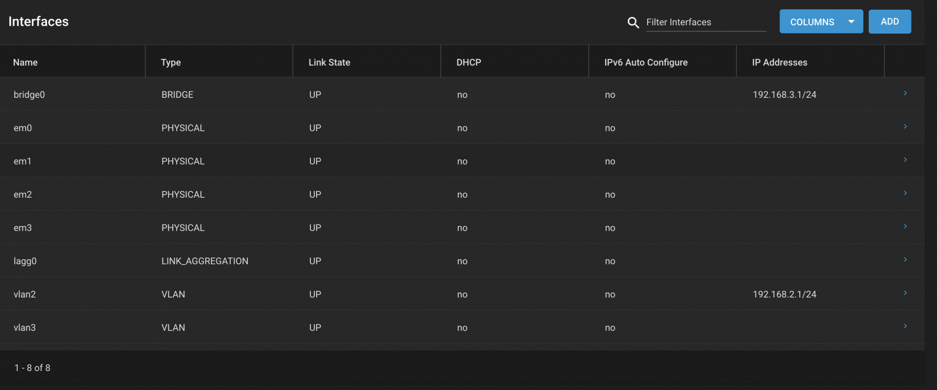

As you can see in the picture, I also have LAGG in the TN and it is not the problem because one of the things I checked was to delete it and check the NICs individually and each of them has this problem.
I also recreated the VLAN and everything.

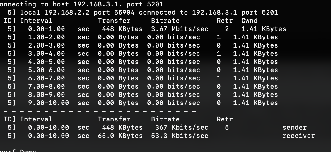

The problem is that I'm trying to do iperf that the TN is the server and I'm using Subnet 3 and from where I check it's on Subnet 2 - I mean it has to go through the gateway I get 3 megabytes and then it drops to 0 Now before you say it's the problem with pfsense it's not, I did the same Testing on other servers and they don't have this problem, and I also did it the other way around checking from Subnet 3 to Subnet 2 the same problem but it only happens on TN and on other servers I don't have this problem.

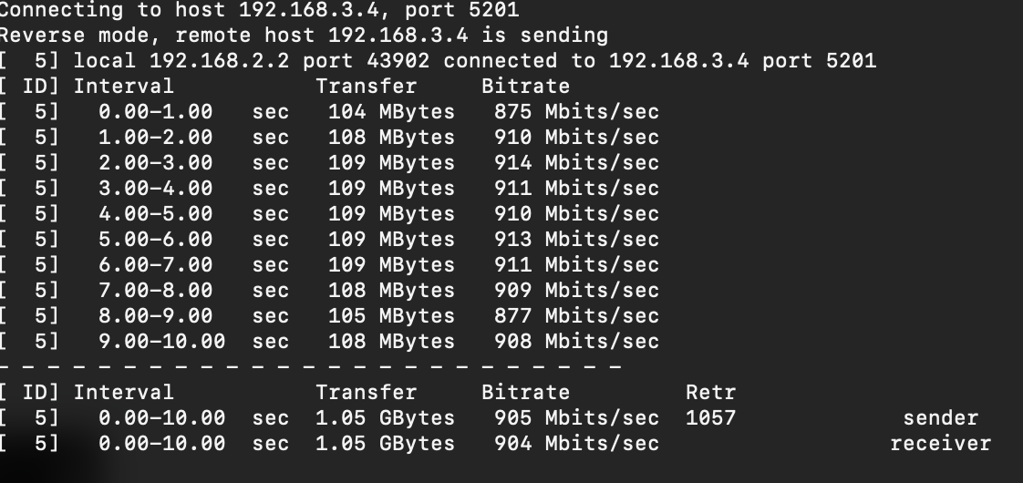

Now I will point out that if I check through a jail that sits on the bridge of VLAN3 then he doesn't have this problem at all.
It's only if I check directly with TN then there is this problem.

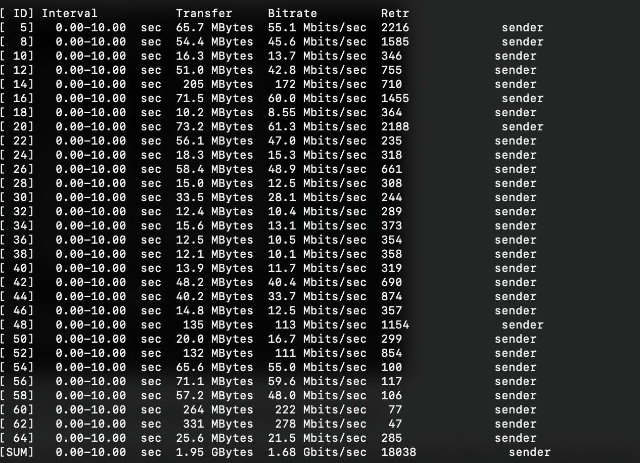

Another thing that I only noticed in recent tests is that there is a relatively high Retr even if I do it through the jail it does finish the test with the speed I expect and also if I do it directly to TN on Subnet2
The first picture is: iperf Reverse mode -P 30 from jail on subnet 3 and the client on 2
The second picture is: iperf Reverse mode from jail on subnet 3 and the client on 2

I will try again, what happens is that if I do iperf or any network traffic (iperf is just to illustrate the problem)
From the TN is the server and it is in Subnet 3 in VLAN 3 with address 3.1
And the clients (let's say Linux Machine) I'm testing with are on Subnet 2 in VLAN 2
So when I do iperf I get 3Mbit and then it drops to 0 as you can see in the screenshots.
The same thing happens in the opposite way, the clients are in VLAN 3 and I try iperf to the TN in VLAN 2. And I mention again that the TN has direct access and an address in VLAN 2 and VLAN 3. Please pay attention to the screenshots of network interfaces, which I think is why this problem only happens with VLAN 2 and 3.
It just doesn't route correctly, and I don't know how to fix it.
