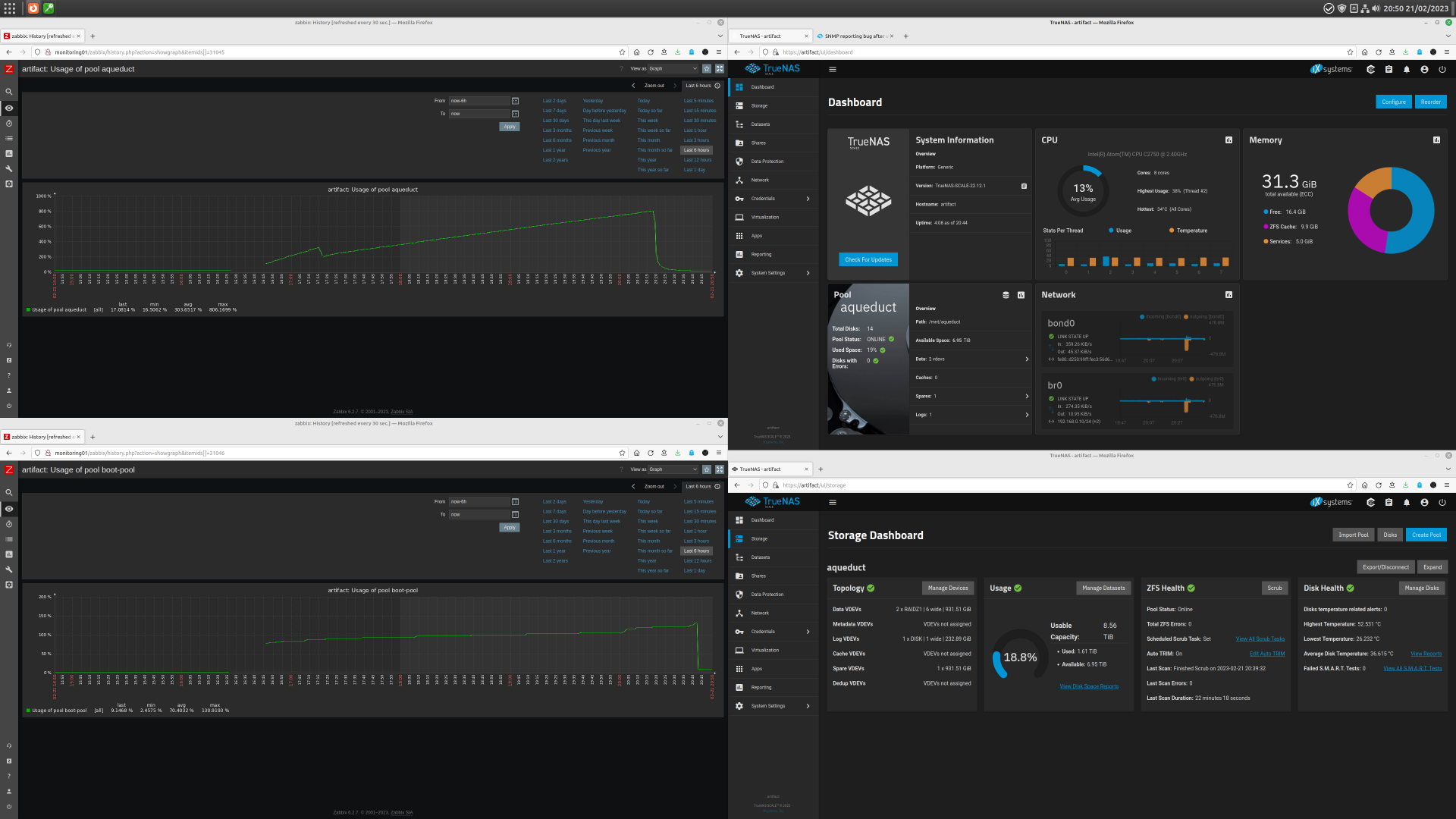

So I just upgraded from 22.12.0 to 22.12.1 and afterwards my Zabbix server started shouting that my boot-pool and main data pool were both over 80% used.
Needless to say this was not actually the case but it appears this was the information that SNMP was providing to Zabbix.
Out of curiosity I performed a scrub and the issue went away. Weird.

Looking at your Zabbix console, it actually seems like your main "aqueduct" pool was reporting over 800% usage. I wonder if it was somehow reporting the wrong metric through SNMP?
Yes the main pool did get up to 800% reported usage as you say. The zabbix alarm itself just triggers at 80%.

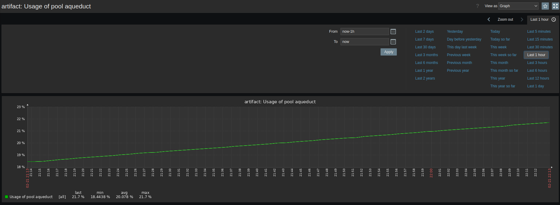

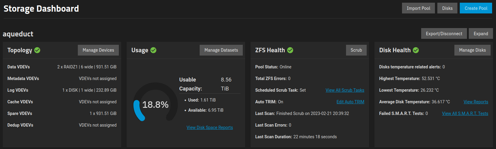

And it look as if the problem still exists. TrueNAS reports usage of 18.8% but Zabbix reported usage is trending up.
