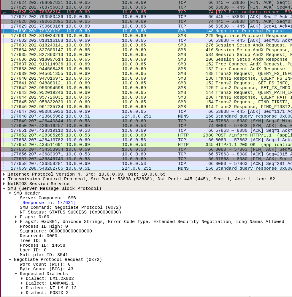

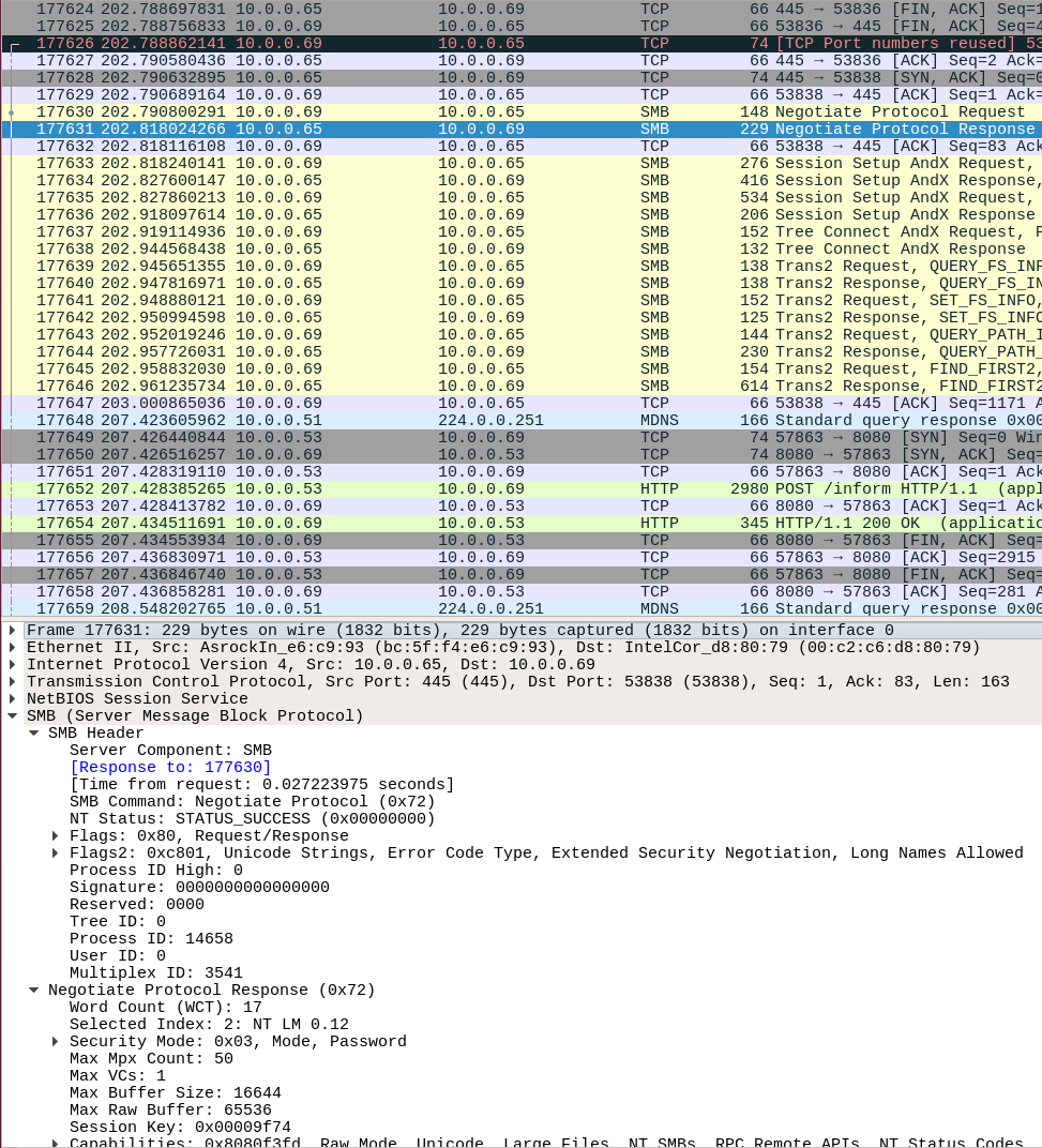

Hello,
My SMB settings are min protocol --, max protocol 3.1.1
My Ubuntu client requests LM1.2, LANMAN2.1, NT LM 0.12 and POSIX 2
FreeNAS responds with NT LM 0.12 which I believe translates to SMB1
If I make SMB 2 the minimum protocol, I can no longer connect.
Anyone know why this is?

It does appear that you are negotiating an SMB1 connection. It might be that your client is configured to do that. Post the smb.conf file from your Ubuntu machine (if you have one set up). What version of Ubuntu? What kernel version? What samba version?
Perform following commands on the Ubuntu Client and post the output:
testparm
uname -a
smbd -V
Establish an SMB session from the Ubuntu client and post the output of the following command on the FreeNAS server smbstatus.
