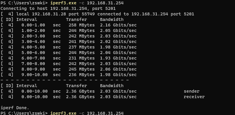

is there any difference between iperf3 and SMB transferring?
I did a iperf3 testing between my PC and NAS
the speed looks correct.
but it didn't do well via SMB

iperf measures only the network transfer rate. Any pair of reasonable systems should be able to saturate all available bandwidth at least up to 10 Gbit/s.
SMB transfers data to and from your storage pool. You need to tell us a bit more about your hardware and setup as required by the forum rules. What's a raidz0, for example? That does not exist.

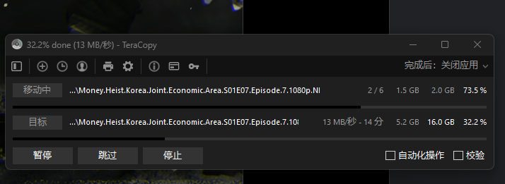

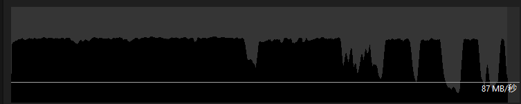

this graph is the recent testing with a 80 gb video file writing to NAS via SMB.
it can keep reaching 250MB/S for around first 40% time and drop to 50MB/S after that
After i pause the transferring, and resume it, it backs to 250MB again but didn't keep the speed and back to around 50mb/s
