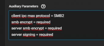

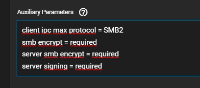

Currently, we have the version TrueNAS SCALE 22.12.2, we have tested each of the directives "server signing = required, server smb encrypt = required, smb encrypt = required, client ipc max protocol = SMB2," individually and in combination, but the "SMB Signing" vulnerability is not being fixed.

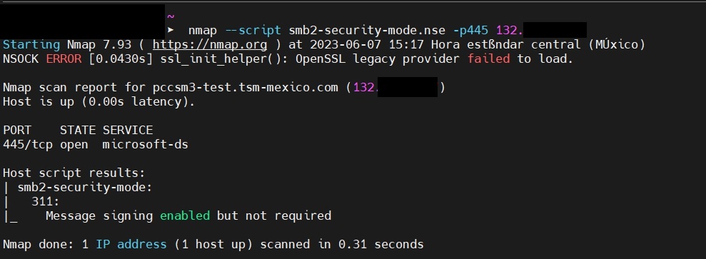

In the previous two versions, this directive "server signing = required" at the SMB service level does resolve the issue, but in this version, that directive and others do not generate any changes. When running "nmap --script smb2-security-mode.nse -p445 ip," the result is "Message signing enabled but not required."

That was a bug in Samba that was fixed in Samba 4.17.10. We're bringing in Samba 4.17.11 in 22.12.4. It was not brought in via out-of-band release because the feature impacted is only available via auxiliary parameters.
NOTE: Auxiliary parameters are a free-form text field where users can more or less paste anything, and so we make no guarantees regarding stability / behavior of any configuration using them and will typically not go out of our way to make special releases to fix bugs that can only occur while using them.
