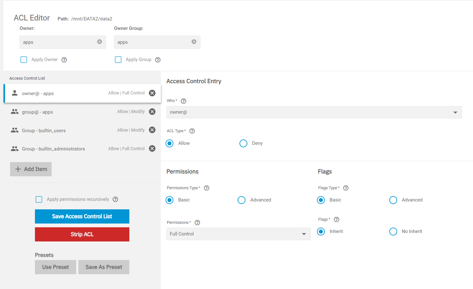

Something def seems off with file system permissions, when I check file system ACLs and click "Save access control list" without changing anything I get "[EPERM] Filesystem permissions on path /mnt prevent access for group "builtin_users" to the path /mnt/DATA2/data2. This may be fixed by granting the aforementioned group execute permissions on the path: /mnt."

Filesystem permissions don't exactly change themselves... Are you running 3rd party tools, scripts or app catalogs?

This sounds like more than just a single Plex container... Knowing how or what destroyed your permissions is a very helpful first step in figuring out how to undo the damage done. Custom things could be custom containers, third party App repositories (like TrueCharts), bash scripts, etc etc. If its something we ship with TrueNAS we should be able to investigate and figure out where the issue came from, and how to undo it. That said, yes you will need to figure out what was changed permission-wise. You usually would need to have proper chown permissions setup or other ACLs so your SMB shares work...
