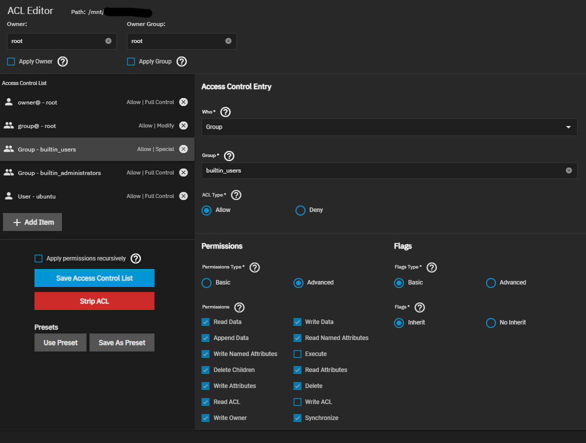

I recently discovered that it is possible to run executables on my mapped network drives from our windows machines. For security purposes I don't want to allow that.

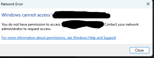

I went into the share settings and under advanced I chose all permissions except for execute:
However then I am not able to access the mount anymore:
switching back to basic (modify) resolves the issue.

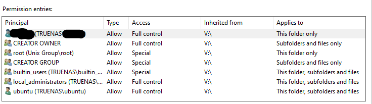

The account from which I am logged in to the share also has Full Control, I assume this is inherited from the owner flag, since I created that folder:

        const int SEC_FILE_EXECUTE         = 0x00000020;
        const int SEC_DIR_TRAVERSE         = 0x00000020;
If you look at windows you'll note that permission to traverse a directory shares a mask with execute. This means the same bit in the access mask means different things depending on whether it's a directory or a file. If you want a bit on directories than a files, then you need to adjust he inheritance flags. For example MODIFY on directories, but MODIFY - EXECUTE on files.
