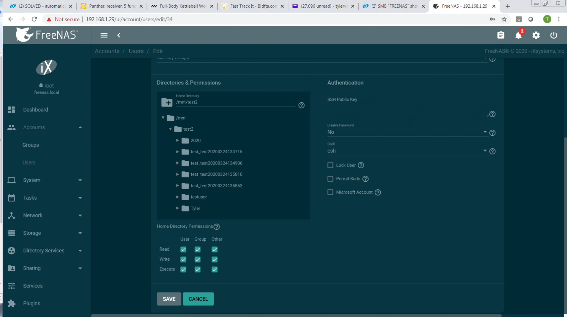

Thanks for your reply. I do have one created, and it IS showing up. The problem is there are not folders or files when I open "FREENAS". Maybe I'm not understanding what you are saying though. See my screenshots.

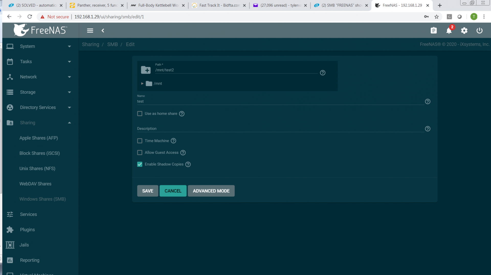

Yes, the path looks correct (See image).
Yes, there are folder/files (See image 2).

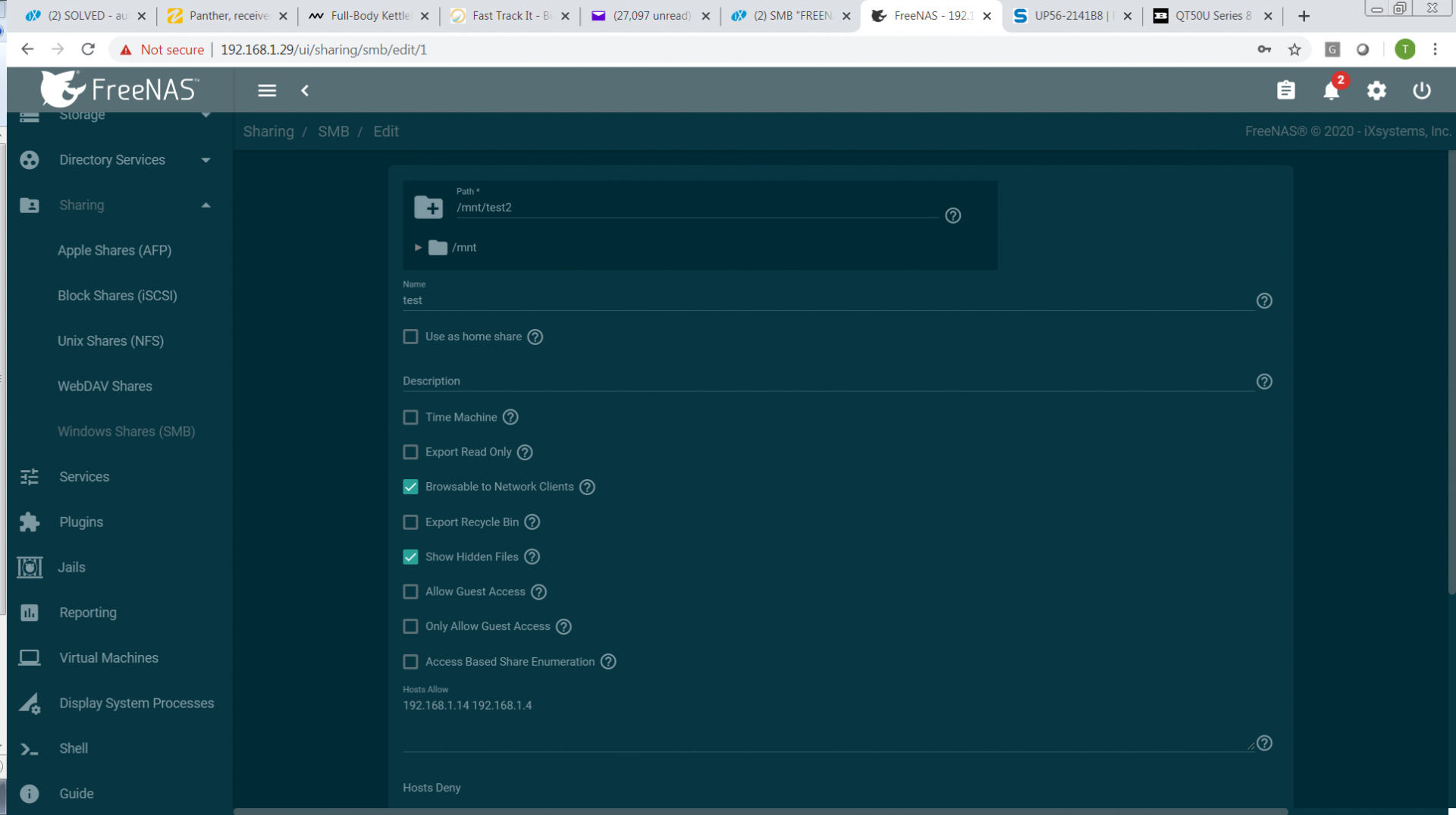

You have not entered the share yet, according to your picture FREENAS.png.
You have tried to access \\FREENAS\test?! (that should be the path according to your config).
Is your share browsable? Check by going to "Advanced Options" in the config of you share.

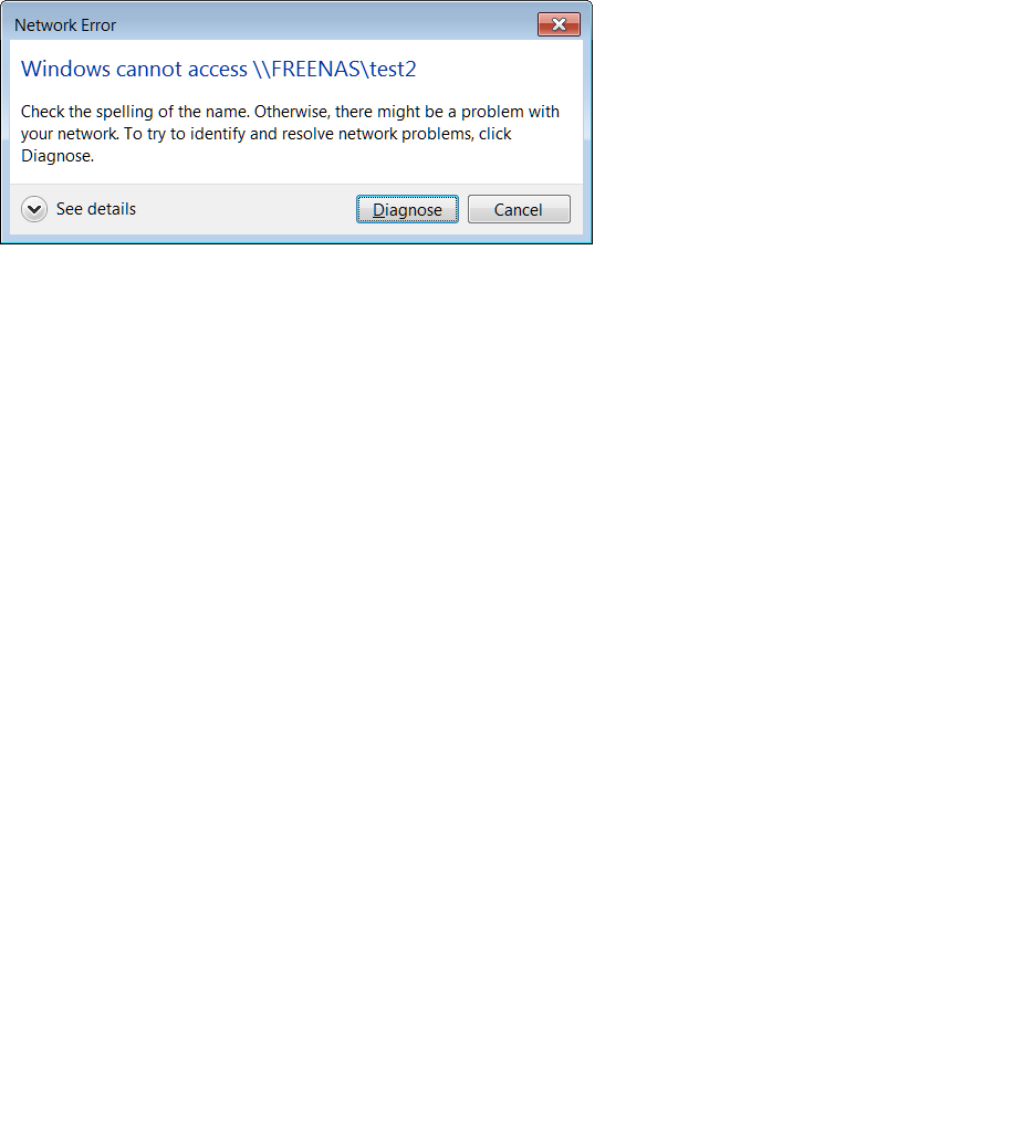

I have tried to enter it, but get an error message.
It is browsable as well.
See images.

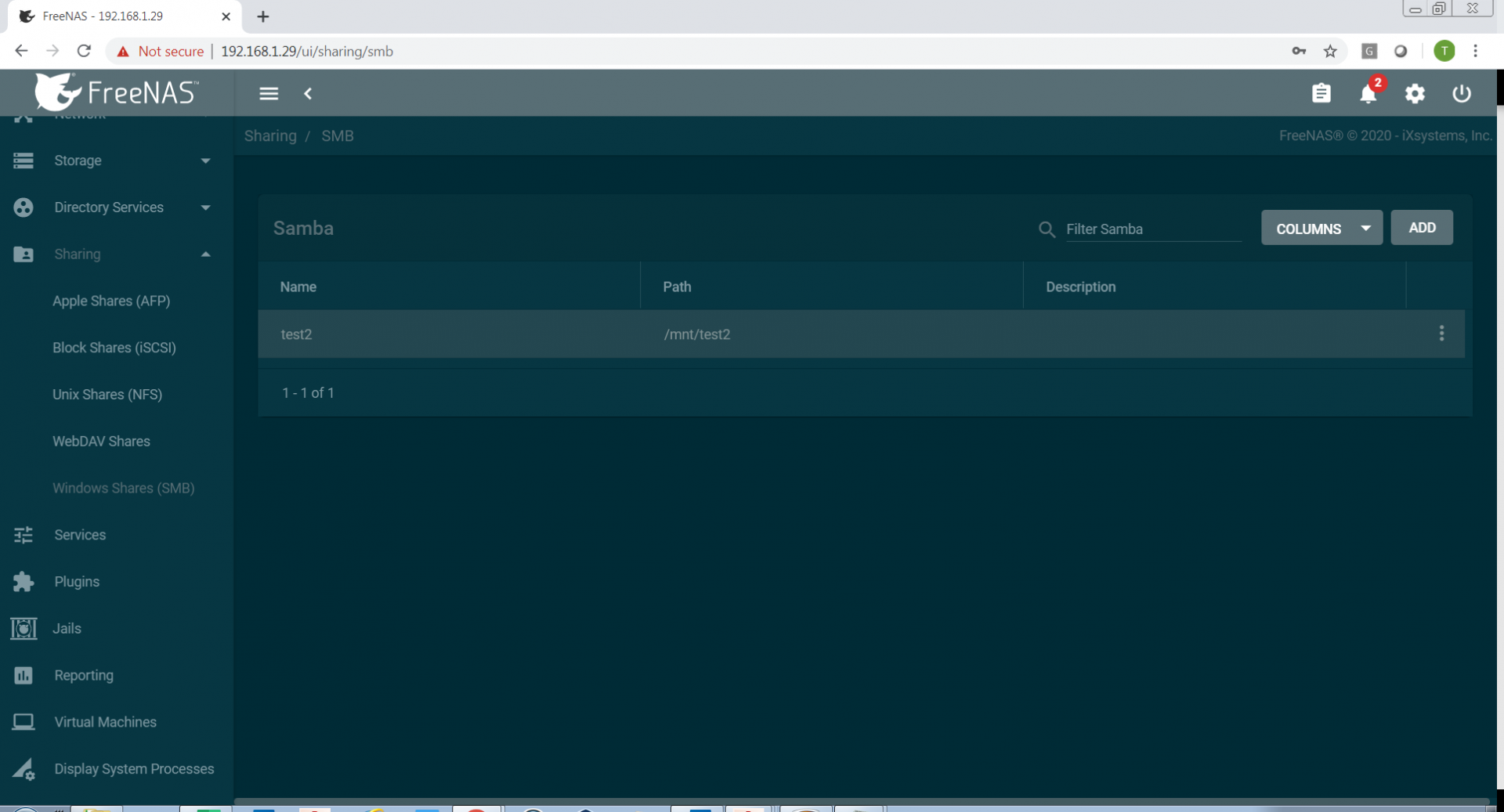

I finally got it!!! Here's what I think the issue was.... I had switched from storing things on a M.2 SSD to this USB external. So I had to point things to the new disc. In the SMB sharing, the share was named "test" with the path "/mnt/test2". I think I changed the path of the share from /mnt/test (the original) to /mnt/test2 (the new), but the name must not have updated (it remained "test"). I deleted this and it actually gave me an error message (should have took a screenshot), but I think it did say invalid name. I then recreated my SMB share and it correctly named it test2. I have attached a screenshot of this page for clarity. Hopefully this helps someone else down the road. Thanks for all the help Fredda!
