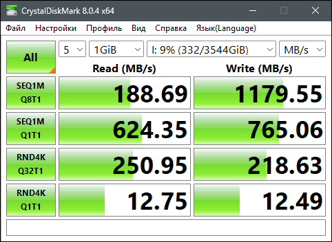

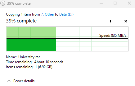

Disks are attached as network drives to PCs, so I can run Crystal Mark tests, and here I see interesting things:
Explorer (download and upload are the same speed):
Speed is ok for a few second at the beginning, but after that it goes down till the end.
