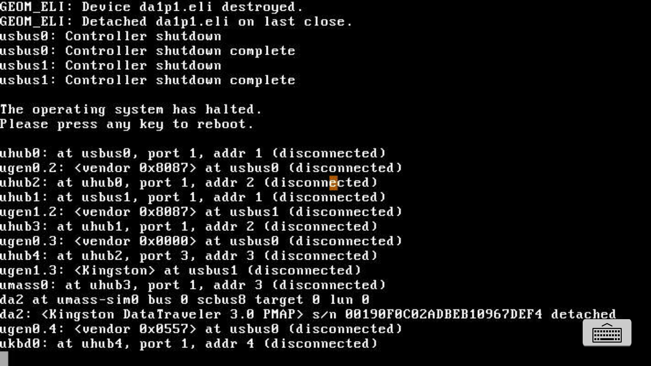

Hey guys,
my FreeNAS server (specs below) wont shutdown. More precisely: If i do a "shutdown -h now" via ssh, the shutdown process will stop (picture below), so that i have to do a hard reset.
If i try a shutdown via the GUI, my FreeNAS wont shutdown, instead it does a restart.
I guess its the same problem, but the shutdown process via GUI will prevent the halt during the shutdown, so it will forces a restart.
So what can i do now?
