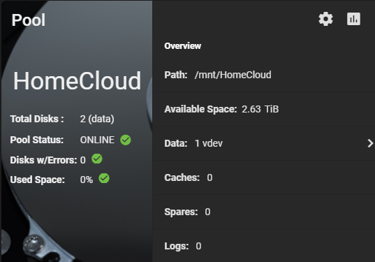

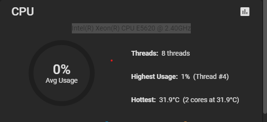

I am new to using TrueNAS 12.0-U5. I have it installed on a Dell T3500, 24Gb of RAM, Intel(R) Xeon(R) CPU E5620 @ 2.40GHz. I have two 3Tb Seagate HDD. I followed the instructions and created my Pool and Share but I can't figure out how to map it on my W10 Laptop. I'm sure it is something easy.
