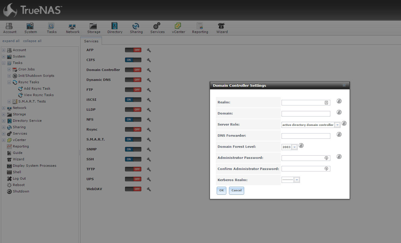

erez
Sep 20, 2015
17
Hi All,
OK i got my FreeNAS to act as a primary domain controller, however whilst I can log into the domain as administrator, I am having some issues connecting RSAT to it. so now trying to get RSAT to work so i can add users. My settings are as follows:
<step 1>
\Services\Domain Controller Settings:
-Realm: DC.EXAMPLE.COM
-Domain: DC.EXAMPLE
-Server Role: active directory domain controller
-DNS Forwarder: 192.168.1.2 <-- *this is the IP i set in Network tab
-Domain Forest Level: 2008_R2
-Administrator Password: strongpass
-Kerbos Realm: DC.EXAMPLE.COM <-- *you dont need to set this. its done automatically when pressing ok
<step 2>
\Directory\Directory Services\Kerberos Realms
-KDC: NAS.DC.EXAMPLE.COM
-Admin Server: NAS.DC.EXAMPLE.COM
-Password Server: NAS.DC.EXAMPLE.COM
<step 3>
\Directory\Directory Services\Active Directory
-Domain Name (DNS/Realm-Name): DC.EXAMPLE.COM
-Domain Account Name: Administrator
-NetBIOS Name: NAS
-Kerberos Realm: DC.EXAMPLE.COM
<step 4>
\Directory\Directory Services\LDAP
-Hostname: NAS
-Bind password: strongpass
