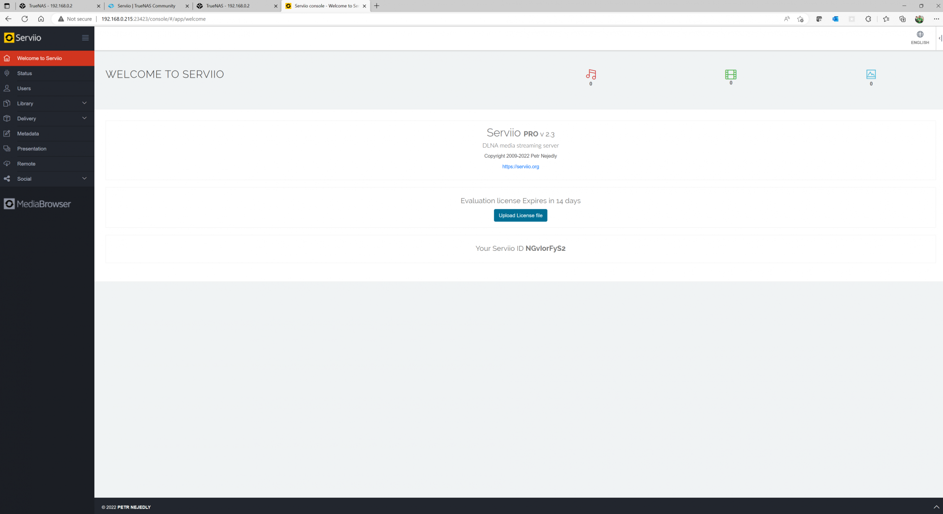

Thanks for all of your help @sretalla and @Patrick M. Hausen ! Instructions worked for me. and I have a running serviio instance on my Jail ... just need to connect the mounts now containing the data and devices in the house (e.g. TV) should find it and be able to serve the content up - will let you know how I get on with that bit !
All up and running now - I had to move my data into a single folder within the storage pool (I only have one pool setup) and could then configure serviio to process my folders (one for Pictures, one for Video and one for Music) and then use the same structure for my SMB shares so can access easily from my Windows devices. Working just fine from what I can see - e.g. TV connects and can see the images / use it via the DNLA service.
I think if you have more than one pool the recommendation is to keep the IOCAGE pool separate to the other pool I have data within - but seems to be working fine with just one mount point on /mnt within the IOCAGE back to the folder where the data is sitting on the same pool.
