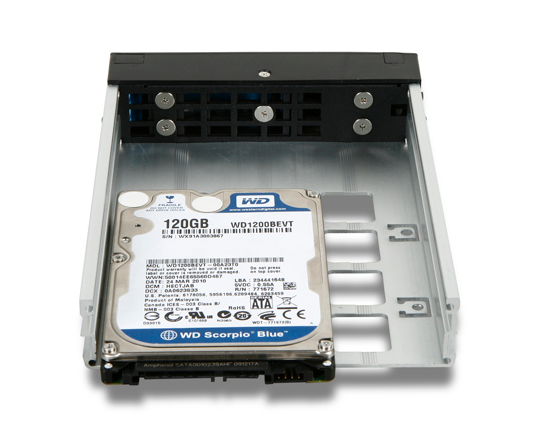

Might be completely unrelated but with a SM 846 we have, we experienced a similar issue. The issue stemmed from how the drives were mounted in the caddie and then mounted in the chassis. We had only used 2 screws to hold the HDD into the caddie. It was secure, with a little bit of give up and down. We were able to slot them into the chassis just fine, and everything worked well, except they ran warm or at least warmer than was expected. (WD RE drives)
After a lot of trouble shooting it was found that the drives, while connected to the backplane fine, where angled slightly when inserted into the chassis causing the air flow around them to be blocked on one side of the drive. After that we decided to use all 4 screws to keep the drive from flexing and the issue went away.
No idea if this is your issue, but might want to check around the drives with some incense or something to see if the drives are getting proper air flow.
I must admit, the 5 drives that ran warm were only screwed in with 2 screws as a temporary install!

So let me get this straight, if you do not use all four screws the drives will run hotter? Is the system on its side or something? Seems to me like it would not wiggle up or down unless you have some serious vibration going on in there.
Weird, I run all my drives with just two screws (diagonally) in my systems. While it is a different make/model, I may test this to see if there are any temperature drops (even though I am not currently worried about my temps). ;)
15,504
I think the thinking is that, with only two screws installed, it's possible that the drive would be skewed in its bay, which could result in impaired airflow. Seems plausible to me, but as I mentioned above, it's not directly applicable to my situation (resisting the temptation to make a joke about screws...)
Was the case for us at least. It wasn't a huge obvious skew to one side but just a slight upward push. It was just enough to divert most of the air flow to only one side of the drive.

A few screws aren't going to do much for heat transfer
I was thinking that the screws provide better attachment to the mating surface, not that the transfer would go through the screws themselves. :smile: But your point is taken, there probably isn't that much of a difference.
I'm surprised by the unbalanced airflow around the drive in these cages.

I figured someone else had to have taken the same shortcut at some point! Lesson learned, they provide 4-6 mounting points for a reason. Who woulda thought?
Which screwholes did you use? I always used diagonally opposite holes.
