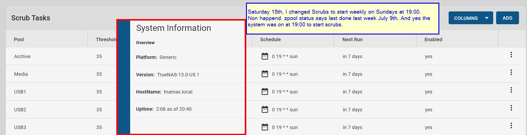

As the title: Scrubs not starting after time change from default. Threshold remains at 35 default.
The default was Sundays at 00:00 with a threshold of 35
I changed it to Sundays at 19:00 keeping the default threshold of 35.
It failed yet it changed over to next run in 7 days.
I tried again at 21:30 and again it failed whilst it again changed over to 7 days.
I can start them manually so I know it works. It must be Cron Jobs as it's the only thing I changed.
Whilst I don't really yet grasp threshold I changed nothing but moved the time forward.

If a scrub had already been run within the "threshold" period (i.e, 35 days), then it will skip its scheduled run.
Doesn't matter if you see "Next scrub in 4 days" or whatever.
The logic is more like this:
"Run a scrub every week on Sundays at 7pm."
"Here comes Sunday!"
"Here comes 7pm! Time to run a scrub!"
"Oh wait. Nevermind. Nope. It hasn't been 35 days since the last time the pool was scrubbed."
Yes, even manually run scrubs affect this threshold.
Ok, you just blew my mind. So why not just say run Scrub once every 35 days on a Sunday. Threshold moots the weekly setting.
So in my case they wont' run again for another 25 days or so? But I've seen them run weekly with default of 35?
Oct 22, 2019
3,641
No day of the week lands every 35 days. :wink: (There are 7 days in a week.)
The threshold + day of the week will assure you that your pool will be scrubbed "monthly" on the same day of the week.
I've never seen this. You're sure you remember it correctly. Maybe you're confusing it with the pool's status on the "last scrub results"?
