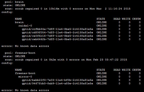

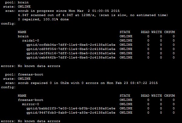

I've had my FreeNAS-setup (specs see footer) for a while now and it works like a charm. I do scrubs weekly (on the night from sunday to monday) when I'm sure, nobody is accessing the server.
Usually, the scrub (for 4.4TB of data) takes around 8 hours, which I think is reasonable. Since last week, it takes around 11 - 12 hours. So, I took a look at the disk activity in the Reporting-page (screenshot attached, all four drives look exactly alike).

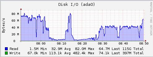

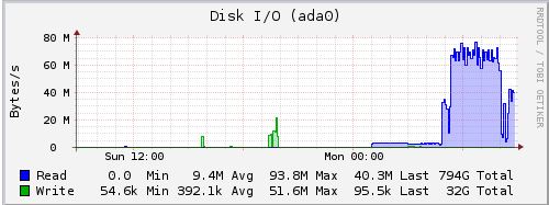

Why does the scrub only read around 2-3MB/sec/drive for the first 3 hours before jumping to the usual 60-80MB/Sec/drive? (screenshot 1)
Also, the performance drops occasionally (screenshot 2). During that time, I was in the car, so I'm sure, no one accessed the server.
The scrub shows no errors, as does the (also weekly) SMART short selftest. Smart-data is clean on all drives.
Any ideas?

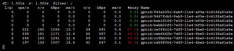

I did a "gstat -f /" during the "slow" times and attached the screenshot. All the drives show roughly the same activity level and data rate. Shouldn't one drive have far higher activity than the others if it were damaged? Also, the "zpool status" shows 100.01% completion. ;-)
After 10:16, the scrub completed without any errors.

I think scrub performance is highly dependent on Dataset content and fragmentation level.
When I do scrubs, I can see the Disk report fluctuate as it progresses. I would say behavior seem consistent from one scrub to the next.
Throughput ranges approximately from a maximum of 100MB/s down to 15MB/s per disk.
On your gstat report, you can see your "%busy" column being close to 100%, with FreeBSD, sampling is not accurate and the information displayed is not always correct. I would suspect the readings are fluctuating above %100 as well.
I noticed your OP/s are in the 200 on the read side and for a scrub I wouldn't expect Writes to happen, but it does, even though the OP/s are low, they are affecting your pool performance.
I don't believe your pool or hardware suffer failure, but I suspect the amount and size of MP3 files is what's causing the scrub to be slow. I also suspect deduplication is not able to keep up due to the insuficient amount of RAM and cause the swap to be written to to alleviate this limitation, hence the writes.
It is also possible the latest update is doing things differently, ie new zfsd feature, affecting overall system behavior.

And the zpool status:
  pool: brain
state: ONLINE
  scan: scrub repaired 0 in 10h16m with 0 errors on Mon Mar  2 11:16:24 2015
config:
        brain                                           ONLINE       0     0     0
          raidz1-0                                      ONLINE       0     0     0
            gptid/ccfbb34a-7dff-11e4-8be5-2c4138a81e5e  ONLINE       0     0     0
            gptid/cd89f054-7dff-11e4-8be5-2c4138a81e5e  ONLINE       0     0     0
            gptid/ce0f6c16-7dff-11e4-8be5-2c4138a81e5e  ONLINE       0     0     0
            gptid/ceb6462b-7dff-11e4-8be5-2c4138a81e5e  ONLINE       0     0     0
errors: No known data errors
