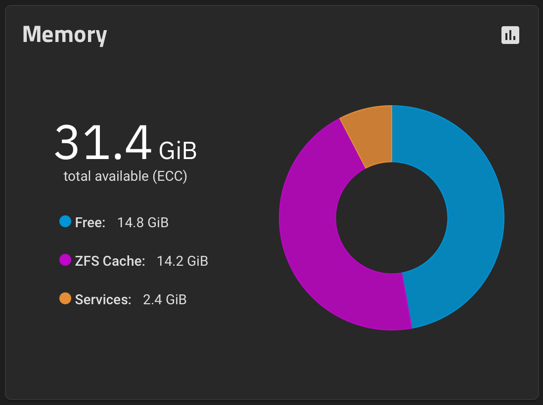

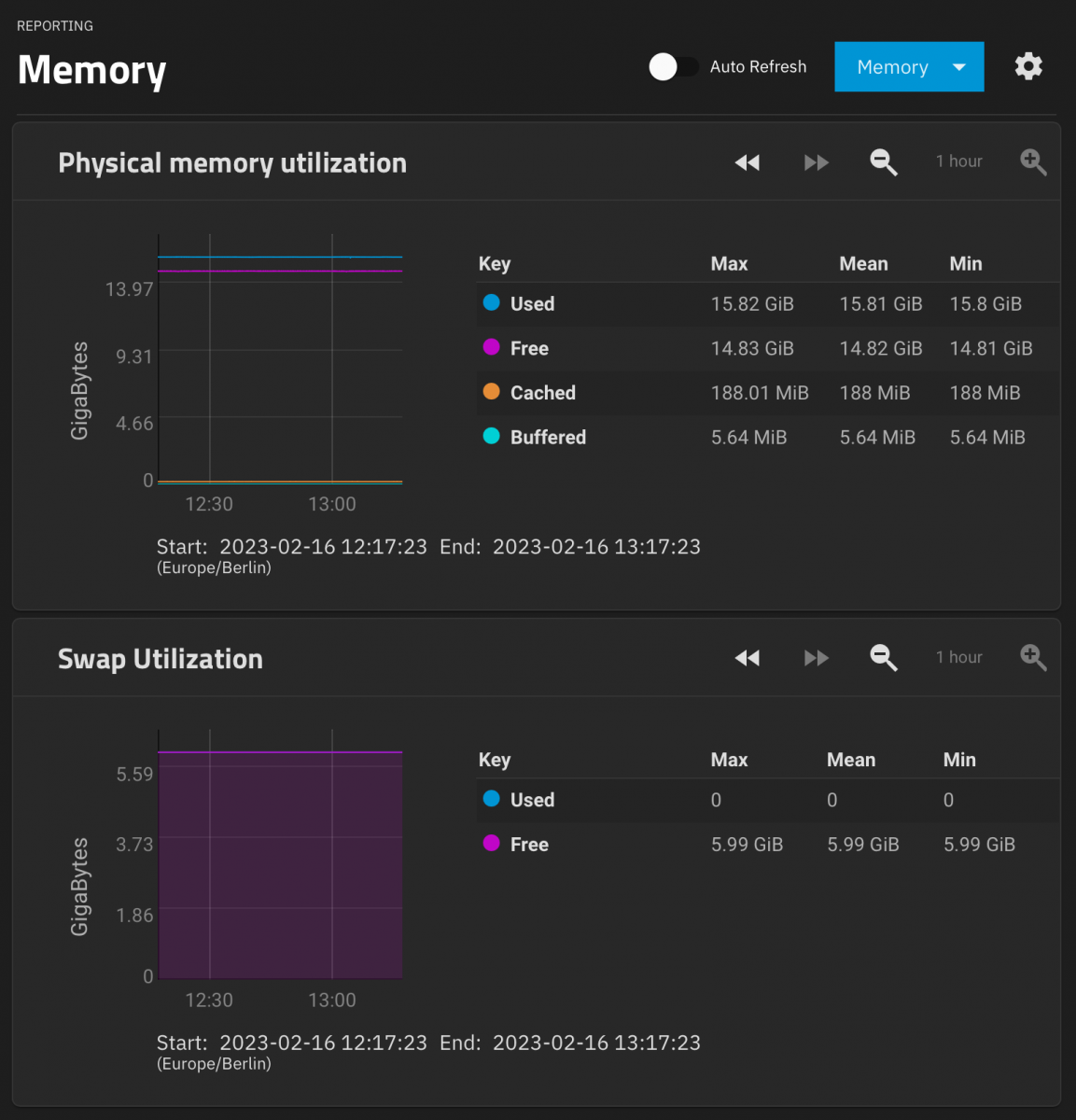

Revisiting that issue ... I currently run TrueNAS Scale as a VM on my Proxmox system and gave it 32GB of RAM. TrueNAS always shows ∼45-50% not utilized. Of course I could make better use of allocating that RAM for other VMs in Proxmox:
Inside TrueNAS Scale I do not run any VMs or Apps / Containers anymore.
Is there a safe workflow for that use case of how to expand the RAM usage closer to 90+%?

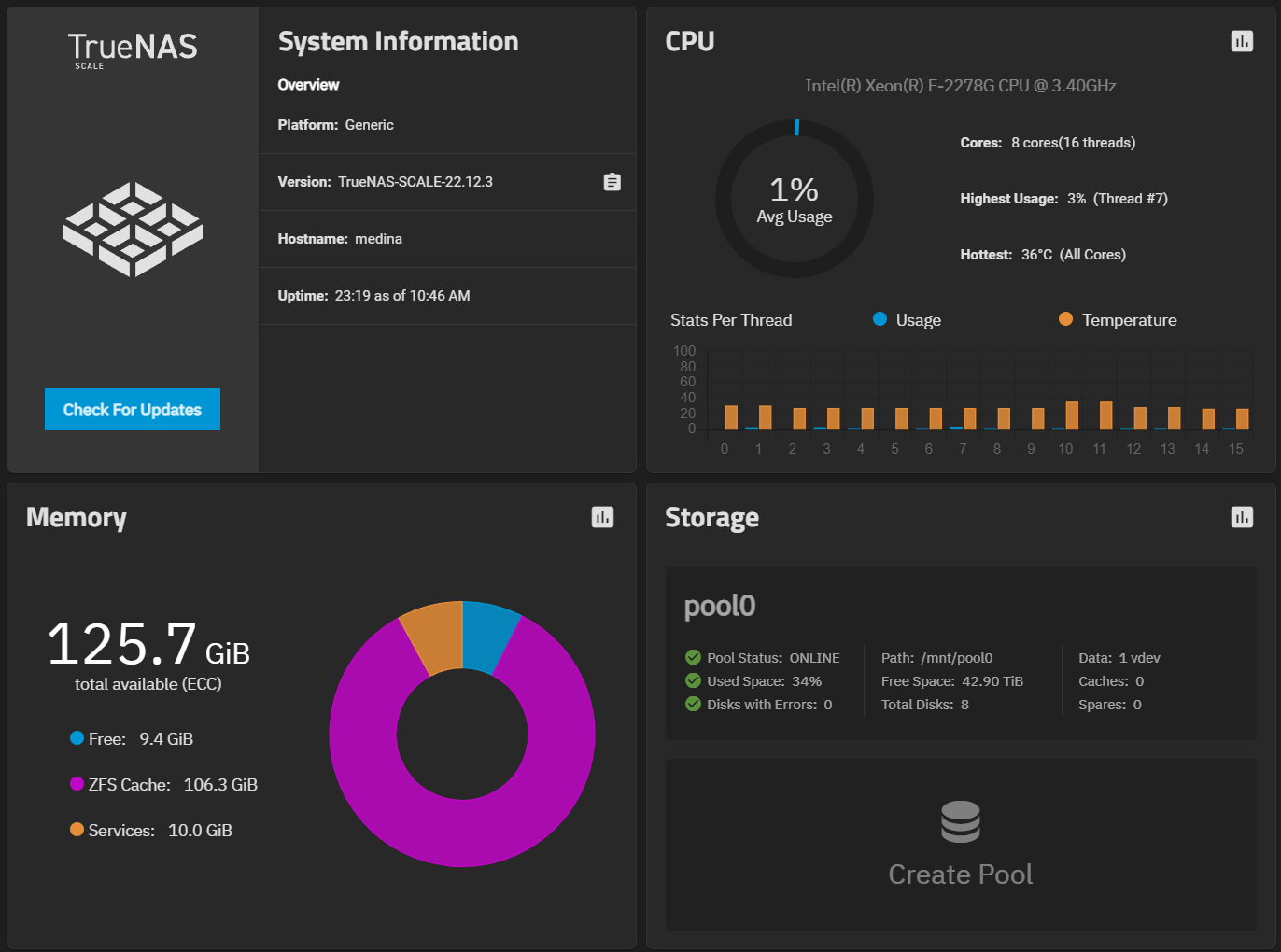

Resulting memory:

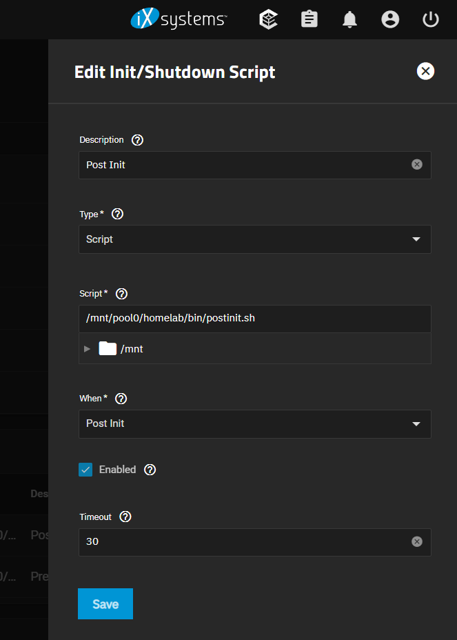

Post init script config:

Thank you so much for your script. I'm trying to follow your method and have a question. Is it possible to place this .sh script in a /root folder on a boot drive and not in a zfs pool /mnt folder?
For example can I place this script here?
/root/postinit.sh
or
/postinit.sh
It is just on my zfs pool drives I keep only datasets and do not want to keep any configuration files.

keep in mind, that if you place the file in /root/postinit.sh and something happens to your NAS and you have to reinstall and restore from backup, that file will be lost and have to be recreated. the backup will preserve the "Init/Shutdown Script" configuration, but not the script itself. It is not odd to make a small dataset for things like this, in my instance, i have a dataset, "homelab" under pool0, i.e. /mnt/pool0/homelab that i keep scripts and tools and such that i wouldn't want lost if my boot drive fails, but is safe on raidz2 + snapshots + remote backups
