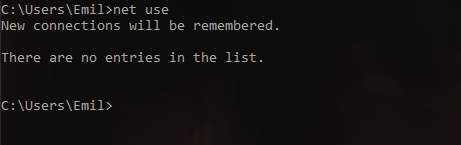

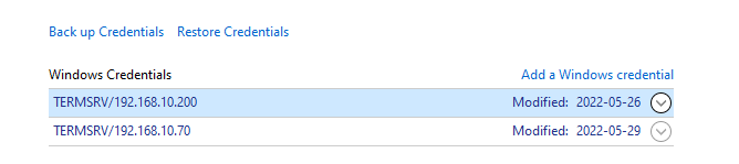

Go to windows, emty credential manager, delete all previous network shares with net use command for everything to be as good as new:

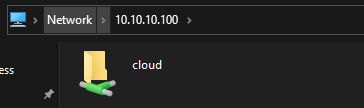

Try to go to \\10.10.10.100 - gets prompted for username / password - enter cloudsvc and password:
Network share is visible, and the samba log shows the auth and confirms it's OK and that the local INTERSTELLAR (NAS HOSTNAME) user was used:

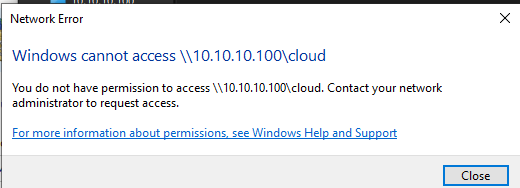

Try to enter the network share aaaaaand boom:

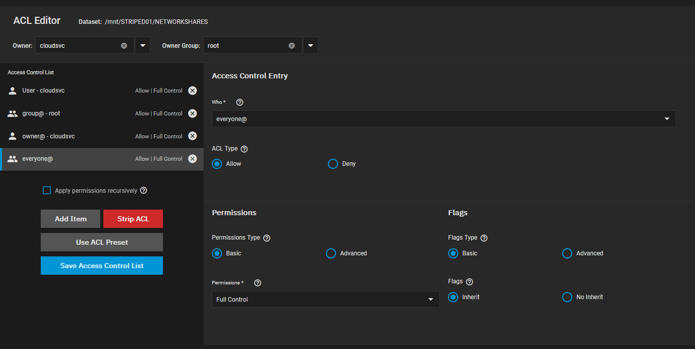

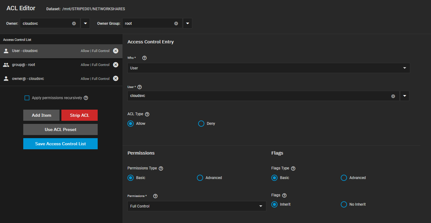

But if we added @Everyone with full permissions on the dataset?
Then it works great. And of course it does, it's never checking any permissions.
getfacl confirms the user has access and is even OWNED by the user I am trying to connect with:

When going through SMB and hitting "View Filesystem ACL" in the UI, I get to /mnt/STRIPED01/NETWORKSHARES/CLOUD which is the actual folder that's being shared - but I made sure to mirror the settings of the NETWORKSHARES ACL on to that one, so there isn't a conflict there either.
I also tried directly sharing the path /mnt/STRIPED01/NETWORKSHARES with SMB just in case - but no dice.

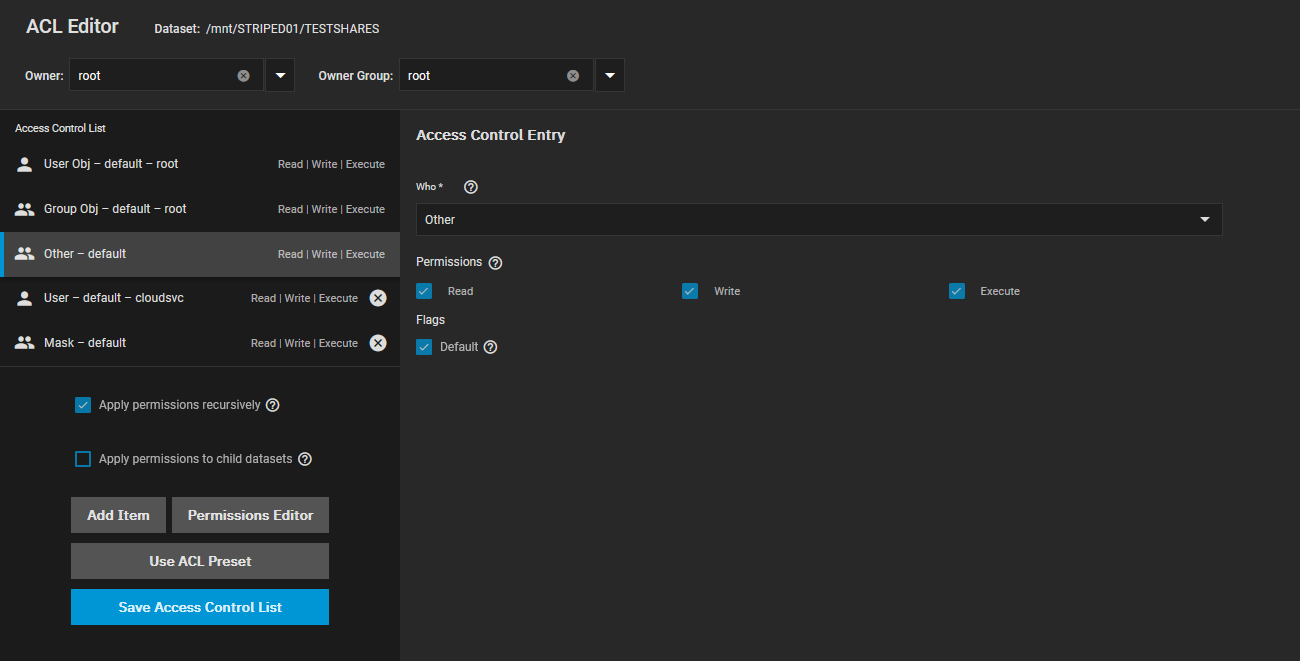

No dice in redoing them, so I figured OK let's just make a new dataset and try - and when trying to set ACL there it's also won't let you progress because:
[EINVAL] filesystem_acl.dacl: Presence of [USER_OBJ] entry is required.
[EINVAL] filesystem_acl.dacl: Presence of [GROUP_OBJ] entry is required.
[EINVAL] filesystem_acl.dacl: Presence of [OTHER] entry is required.
All 3 which are clearly there.

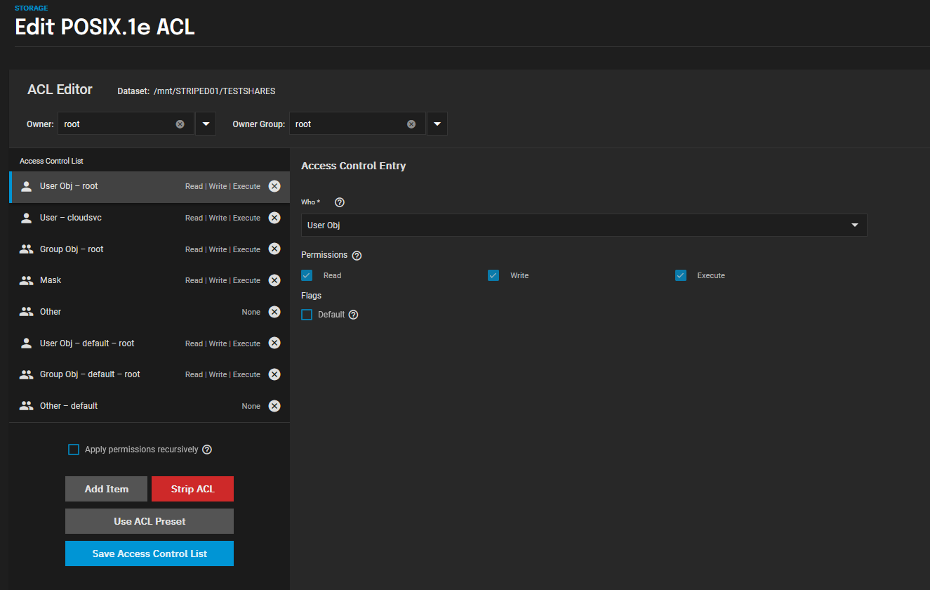

Also tried using POSIX RESTRICTED preset ACL, and just add the user to it, and then share that dataset:
But still no permission. There seems to be massive issues with permissions in SCALE for sure.

POSIX1E ACL is incorrect above. It grants de-facto 770 permissions with root:root on all paths below the root. No one other than root will be able to access files. POSIX1E acltype only exists in SCALE so this dataset didn't come from core. If you want to use POSIX1E acltype, then you should probably add a default explicit group entry for the default SMB group builtin_users to the path and apply recursively.
If you are using NFSv4 acltype (the type default in FreeBSD), then you can set an inheriting GROUP entry for builtin_users to do the same. One difference between Linux and FreeBSD is whether gid for a new file or dir is inherited from parent dir or set based on gid of creating process. Former is FreeBSD behavior and later is Linux behavior.
In next 22.02 release I have changed ZFS so that in case of NFSv4 ACLs we keep the FreeBSD behavior (since this will ensure permissions behavior are consistent across both platforms when NFSv4 ACLs are selected) to ease migrations for users who are not taking advantage of flexibility of ZFS ACLs to set explicit group permissions rather than relying on OS implementation details for permission (via GROUP@ entries).

Big picture with POSIX (not NFSv4 ACLs), you have two separate lists:
1. ACCESS - applies to current directory / file
2. DEFAULT - applies to newly created files / directories in the current directory.
And there are six different qualifiers that each entry can have:
1. USER_OBJ (the owner of the file)
2. USER (a separate user)
3. GROUP_OBJ (the group of file)
4. GROUP (a separate group)
5. OTHER (anyone who isn't owner, member of group, or in another ACL entry)
6. MASK (sets the maximum permissions for additional group specified in the ACL)
From the standpoint of what you see in the GUI, the ACCESS acl gives you the permissions for the current path (dataset mountpoint). The DEFAULT ACL tells you what any existing file or newly created file will get. Basically you need to have entries for both. There are also mandatory entries in a POSIX1E ACL:
1. USER_OBJ
2. GROUP_OBJ
3. OTHER
These must exist in ACL and there may only be one ACCESS and one DEFAULT entry for each other them. The backend also requires that a MASK be defined explicitly (because we don't want implicit permissions behavior).
Yes, this is quite complex. I think the NFSv4 ACL option is significantly simpler in that there's one list and you choose explicitly whether you want particular entries to inherit.
You can change acltype in the storage plugin.
That said, this is the way that POSIX1E ACLs work in general on Linux, and since we receive data rsynced from Linux servers (and potentially ZFS replication from other servers using ZoL), we have to support them in the webui.
