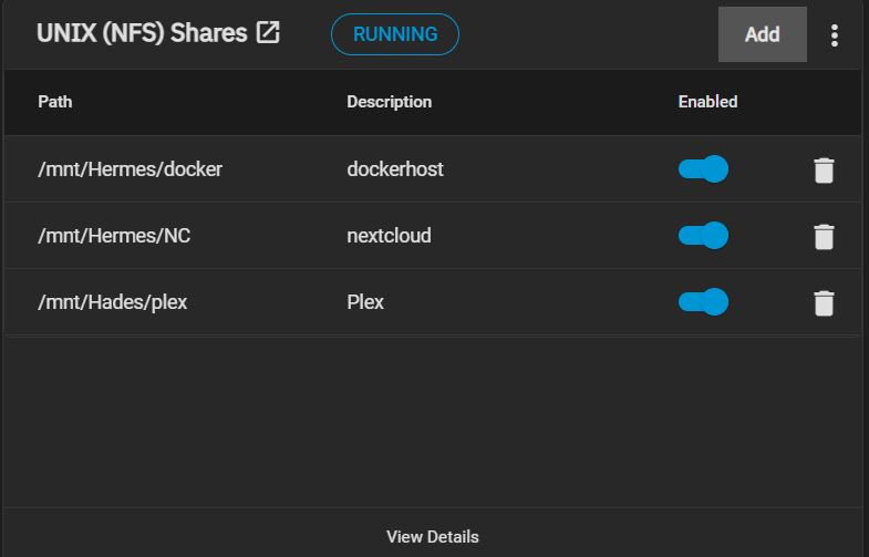

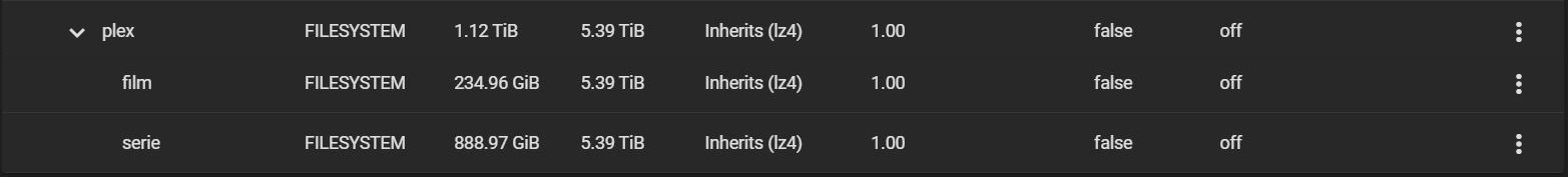

This are the datasets, <poolname> > data and plex > the rest in pic below
This are the shares:

I was able to get a similar setup working by exposing both the main NFS mount point as well as the individual NFS mounts, while only needing to actually mount the top-level NFS mount from clients. In your example, that would be having NFS Shares (exports) for:
  • /mnt/Hades/plex
  • /mnt/Hades/plex/film
  • /mnt/Hades/plex/serie
Enabling NFSv4 in System Settings -> Services -> NFS -> Enable NFSv4.
Then, mounting just /mnt/Hades/plex, I was able to access both the root dataset as well as the child datasets from the single mount point.
