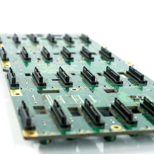

That is a related but different question. To me, the best solution to both was to use a server chassis that had a printed circuit board that carried both data and power to the drive connectors, like this:
You can pickup a used server chassis on eBay for a good price. I picked up the one I am using for around $300 and it included a hot-swap redundant power supply and 48 drive bays. Makes cable management super easy.
