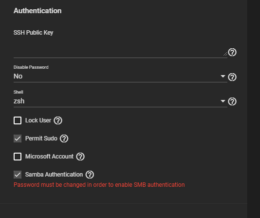

Hello, my DIY server works with True Nas-12.0-U1.1
No access to root files SMB trying to enable "Samba Authencation" message : " Password must be changed in order to enable SMB authentication" after changing password next message is :"This attribute cannot be changed" Is it one more bug?

Since 12.0 Root has no longer acces to smb shares. create a new user with the right permissions and reconnect your share.

Ok I didn't know thank you. What are the right permissions for the user to access /root? (same permissions of root user)
