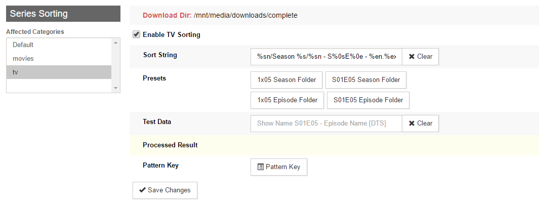

Not sure if this is the correct place for this question but when my Sabnzbd downloads tv shows passed from sickbeard sometimes it makes the same tv folder but in a different format.
For example one day it'll download and make a folder "Chicago PD" and the next it'll make a folder called "Chicago P D" with a space.
it does this for multiple shows including:
Marvels Agents of S H I E L D - Marvels Agents of SHIELD
Hawaii Five-0 2010 - Hawaii Five-0
Scandal - Scandal 2012
The Flash 2014 - The Flash
NCIS LA - Ncis Los Angeles
I have lived with it for a while and just wondering if its fixable so it just makes the one folder for each of those type of shows.
Sabnzbd does the post processing and looks like this:

I have never seen someone actually use that feature. everyone I know uses post-processing in sickbeard or nzbtomedia

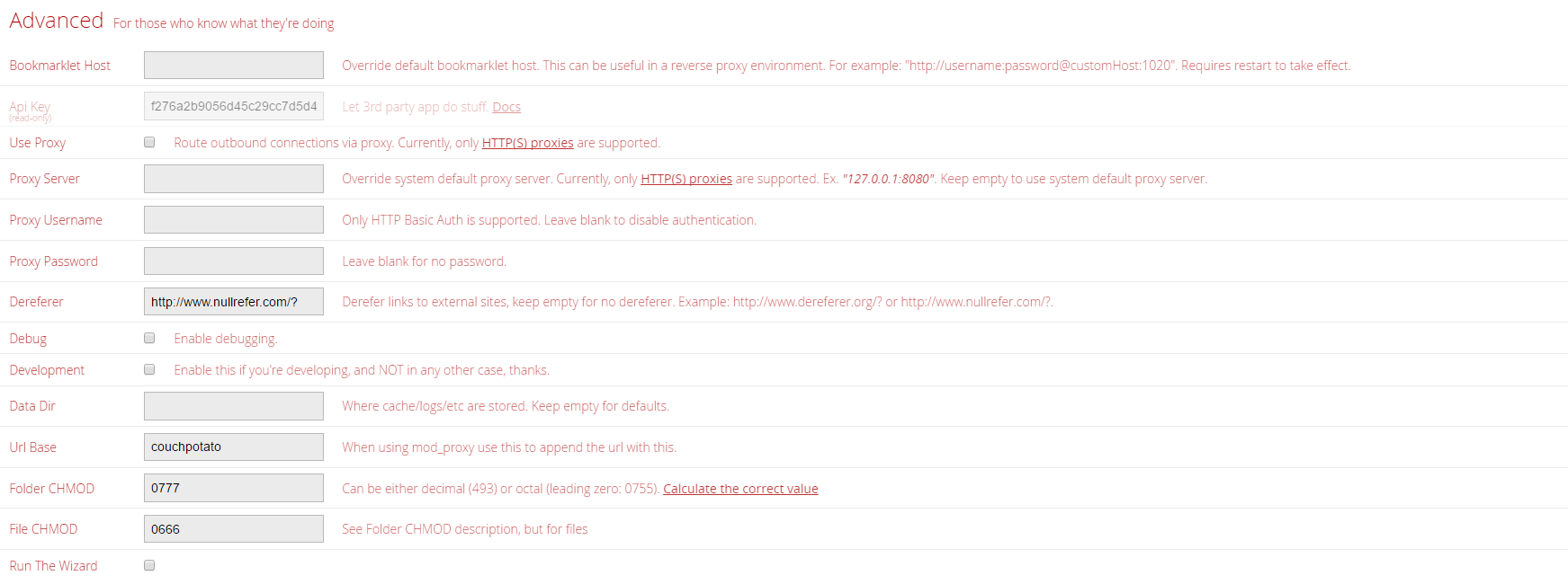

Hi Christopher,
1) Did you set the webroot settings in sickrage (in it's config) and couchpotato (in its advanced settings), then restart those plugins?
If not it won't know to listen at those URL paths. sabnzbd listens at both "/" and "/sabnzbd" by default.
2) What does couchpotato have for that movie under Movies > Manage? It should say where it moved the files to.

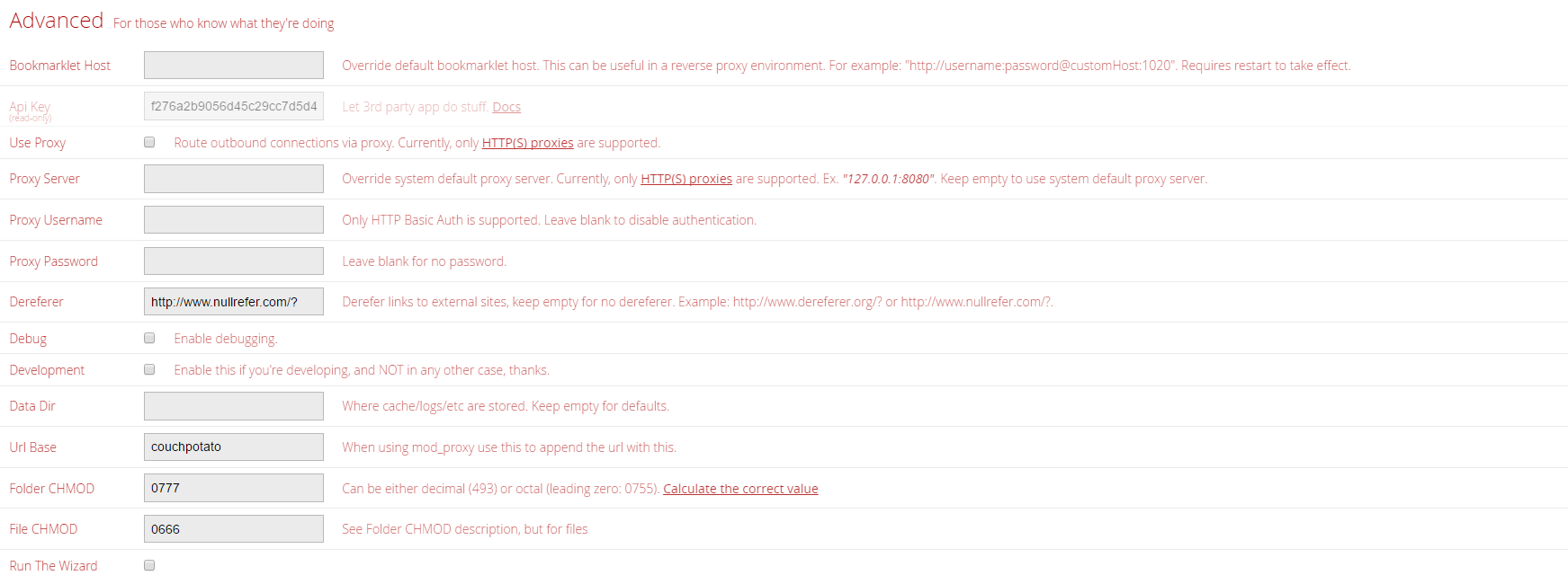

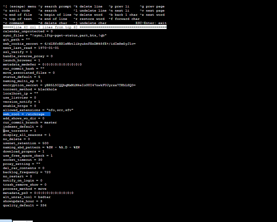

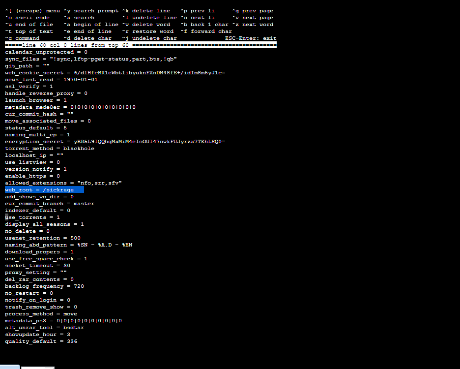

Hi Christopher,
I tend to watch a lot of shows and it's hard to keep track of where i'm at unless i do it like that.
I have the couchpotato Url Base set to "couchpotato"
I set the web_root when i was following along with your video via ssh with "EE /var/db/sickrage/config.ini"
see attachments.

something like emby/kodi does that for you. it manages your watched status, and where you are in every episode.

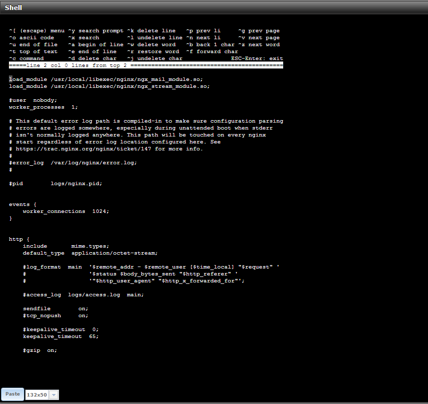

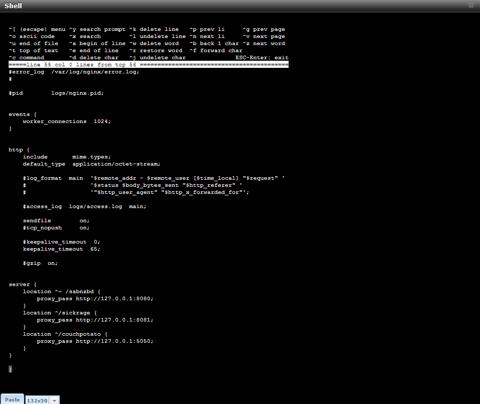

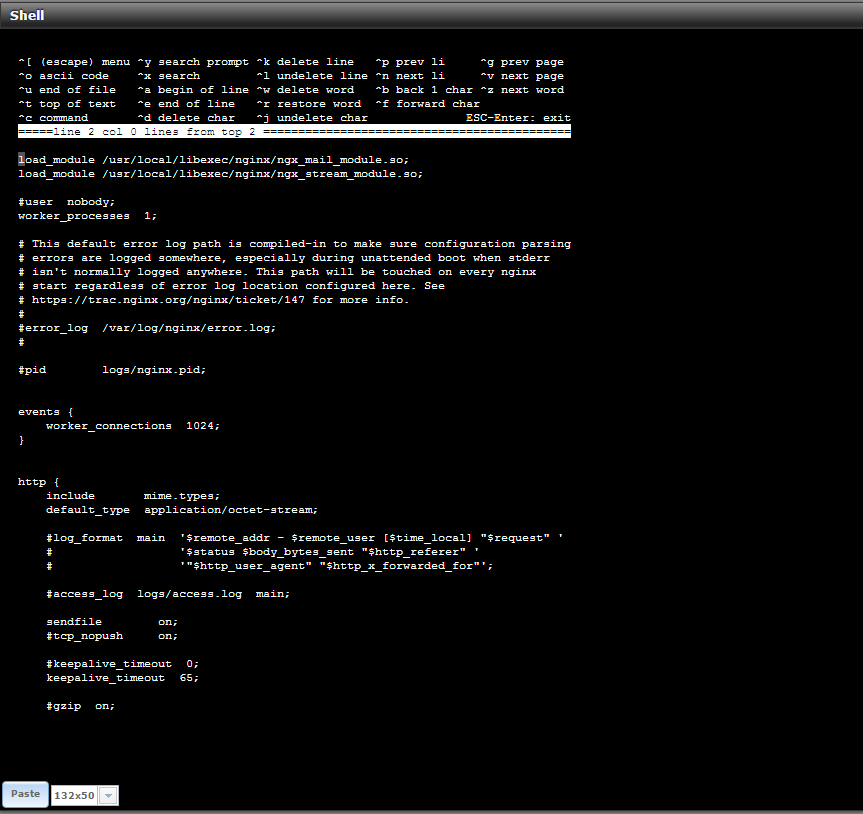

Can I see a screenshot of your nginx config?

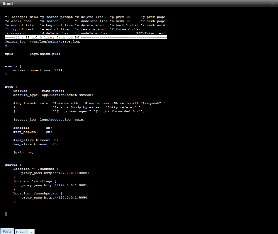

check your server block, there are some typos there.
I see alot of people get that same typo. Maybe a symptom of using the web terminal.
Christopher Ward
May 14, 2015
104
I copied and pasted the server block part from the website, i done it again and started the service and get:
root@sabnzbd_1:/ # service nginx start
Performing sanity check on nginx configuration:
nginx: the configuration file /usr/local/etc/nginx/nginx.conf syntax is ok
nginx: configuration file /usr/local/etc/nginx/nginx.conf test is successful
Starting nginx.
root@sabnzbd_1:/ #
but i still get the error
Starting nginx.
root@sabnzbd_1:/ #
look at each line starting at "location". What you have is not correct.
