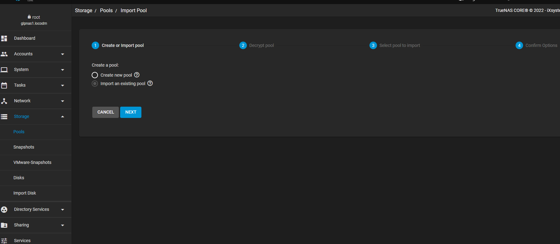

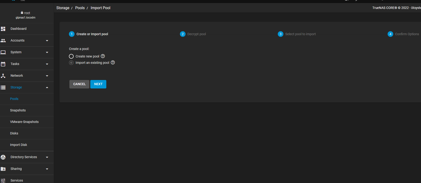

you can't export the pools since you already erased the system that had them imported.

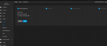

go to storage, pools, add, and import the pool. that's it. as you go through the steps, it will show you any pools that are available to import.

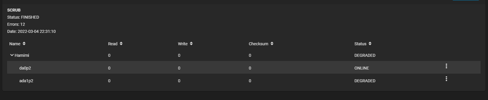

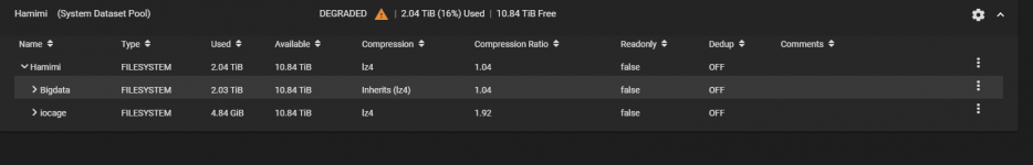

Thanks a lot for your reply. I have imported them but they showed 'Degraded'. Then I started to Scrub the pool and it was a very lengthy process. I should go and check the status now again. Did I do the right thing (was late last night Eastern time)?
Hamimi
Dec 22, 2021
21
Here is my situation. Hope you experts can help :-(

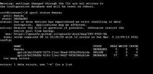

Here is the Zpool status for Hamimi. Seems like there are too many errors. I did Scrum the pool but still no luck., Guys, do I have any chance to recover my data?

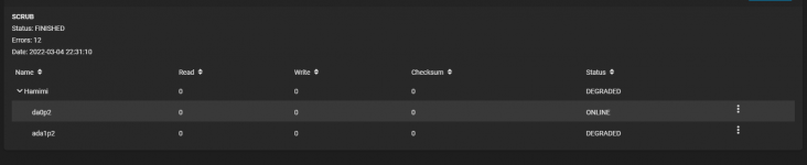

Here is the status after Scrub the Disk is completed.
artlessknave
Oct 29, 2016
1,506
if I read this correctly, you appear to have a pure stripe pool. any disk being unavailable makes the pool inaccessible. if so, you built this pool with zero redundancy, there is nothing to recover from.
Main SSD: Windows is installed on it; USB External HDD where Linux Truenas is installed for storage;
this only makes sense to me if you tried to virtualize TrueNAS in windows, which is not a good idea. virtualization adds many extra points of failure, and, while it can be done, MUST be a done in a few very specific ways, none of which I see here.
not only is your hardware not recommended, much of this setup is specifically highly discouraged, for reasons like what you are experiencing first-hand.
ZFS does not work well on USB drives.
the best option you have to get anything of this back is to shut it all off and send it to professional recovery services, and pay much $$$ for it.
from what I see here, you would have been far better off just storing this data on NTFS usb drives.
if you are able to get it imported and read any kind of data, IMMEDIATELY COPY ANYTHING YOU WANT TO KEEP TO A SAFER LOCATION.
do not wait to try and recover the original pool, because at this point it's on it's deathbed and you need to plan to replace it, or, better yet, just use USB drives with windows.
also, probably stop trying to scrub it, that will just put more stress on an unhealthy pool.
