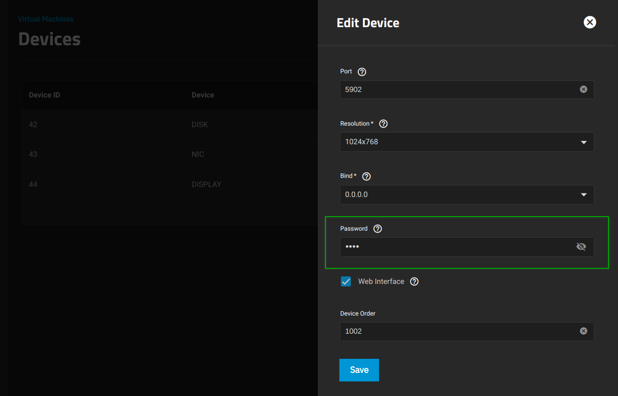

I don't think you can remove the password completely, but you can make it as short as one character.
To change the password after the VM is created:
1. click on the devices button for the VM
2. click three dots to bring up the menu for the display device
3. then click edit

made the password 1 character when I tried to save it sits there with the scrolling bar not saving
Sorry my suggestion ended up forcing you to delete the VM.
Are you on version 23.10.1 of Scale? I'm asking because I tested a one-charter password before making the post, and it saved successfully. Also, I think the VM needs to be powered off when making the change.
Did you connect to it after you set it to only one character?
Last I tried, it wouldn't connect properly. And thusly needed to be a two character password at minimum.
Tried it myself. And even though the VM needed to be shutdown completely before the change actually applied. It could be as short as a one character password.
