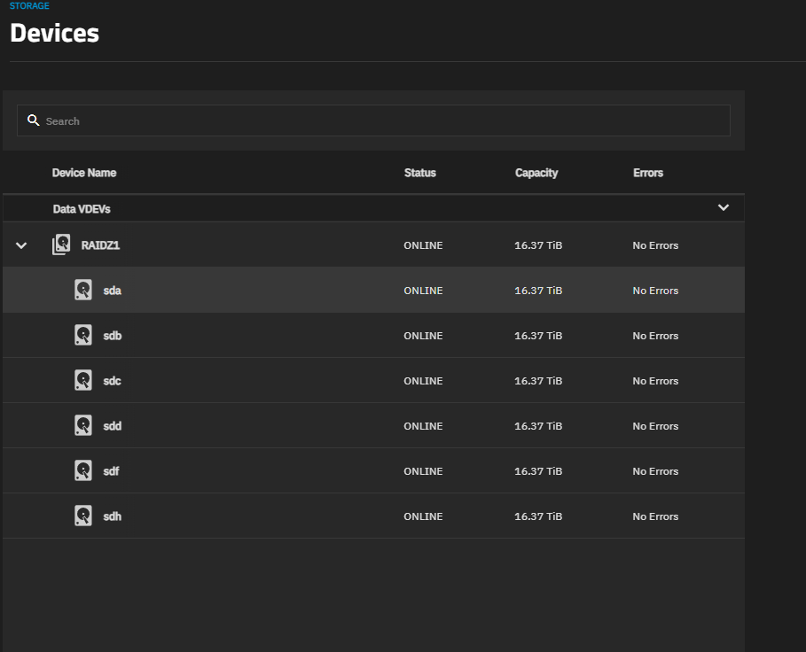

Hello. I really need to remove a spare disk on a pool permanently, and create another vdev. Vdev1 has 6 data disks & 1 spare. I have available another 5 disks for Vdev2 creation but i will need 6 total thats why i want to remove permanently the spare drive as part of the vdev. Please help as no option in GUI is available, and i dont want to CLI a command that could possibly degrade my pool or even destroy any data as they are mission critical.
I dont want to replace, but remove entirely the role of spare from my vdev. Please help!

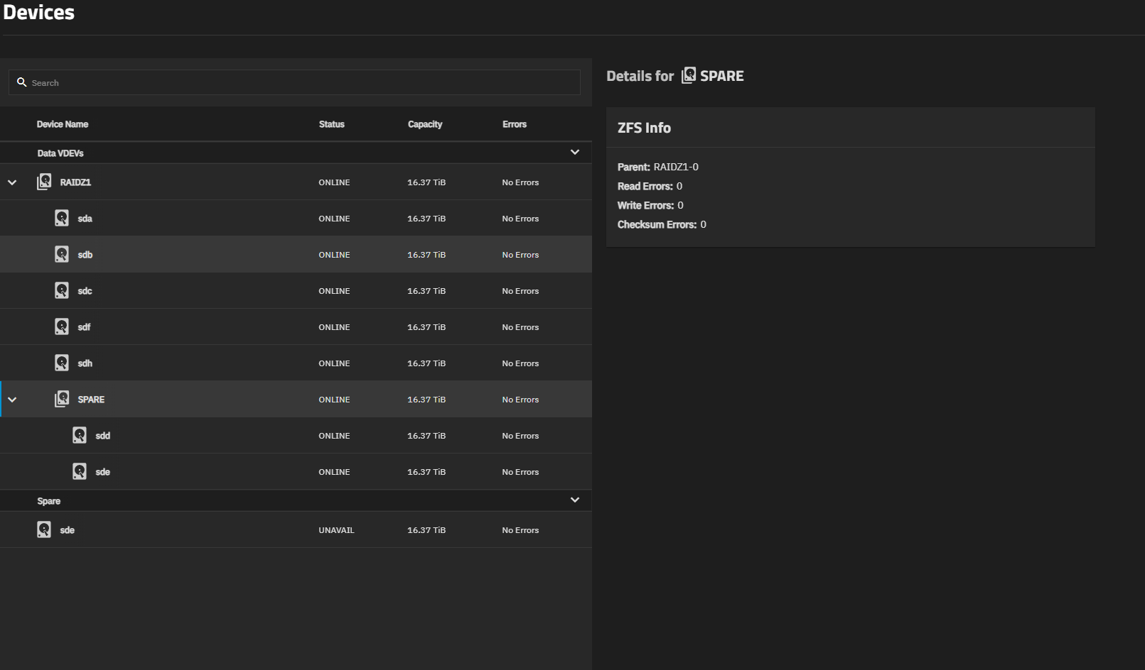

Also as i tried hard removing by hand the spare drive it automatically created a different pool called SPARE inside my RAIDZ1. Started resilvering also...

Arwen
May 17, 2014
3,611
Your Spare drive is now in use. That "SPARE" has both the failing drive and the Spare drive. That is how it appears when a Spare drive is in use.
Now I don't know WHY your Spare drive is in use. The pool drive "sdd" does not seem to have any errors.
I will have to let someone else continue, as I don't know how to proceed.
I don't think the spare drive is the drive you think it is...
You need to check in Storage | Disks and see the serial number associated with the spare (sde currently), then match that to the serial number written on the drive. it looks like you accidentally pulled the drive currently shown as sdd instead, hence the spare kicking in.

Guys let me explain. As i removed the "Spare" - sde (by hardware removal), automatically RAIDZ1 created SPARE by using other unmaped HDD's that where available to system. Once i plugged back in sde resilvering started. Now resilvering stoped and im back to picture no.1 with "Spare". Then i tried what "sretalla" suggested and it worked!!!
Now i have a fully working system as it should be.

I was in the very same situation as shown in this picture:
Thanks for your reply. Unfortunately i get the following message:
Indeed I found this thread while looking for a solution.
The hint was in an older (2019) thread: while apparently we cannot detach the spare drive (sde), we can detach (via the webui) the "replaced" drive (sdd), this promotes sde as a full member of the data VDEV and makes the sdd available (assuming it has no issue).
My case started with errors and erratic behavior of one disk, which activated the spare drive. It turned out the issue was not the disk but the board, which I replaced, with the result as in the picture.
