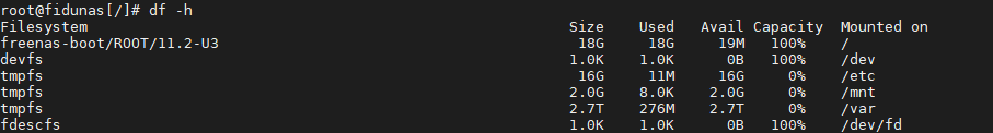

Good afternoon, I have this problem with my brake service, all the documentation tells me how to extend dataset's, but I cannot find information on how to expand this partition on time, the system boot partition, I do not know how to extend it, and I am quite concerned because the performance is affected too much.
I will be eternally grateful if you could help me.
Thank's

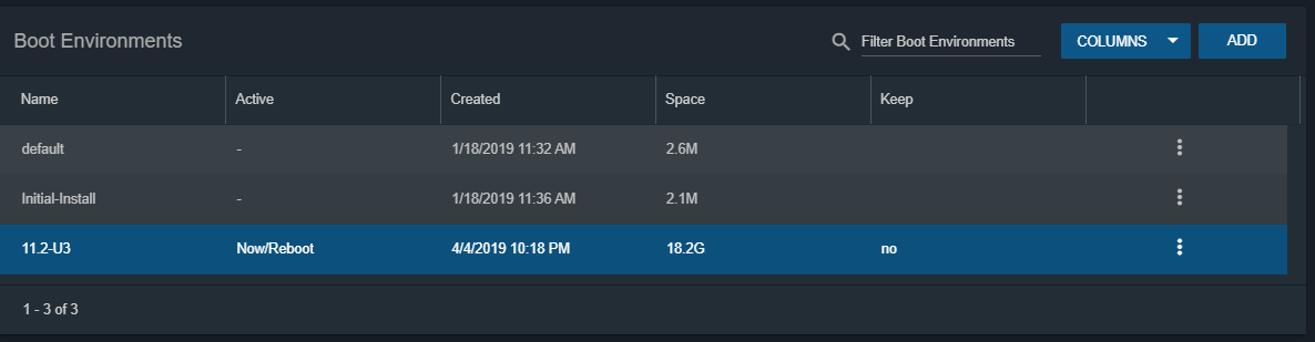

If you go to the System | Boot settings, delete some of the older boot environments you have.
OmarNoah
Mar 11, 2020
22
That's the weirdest thing, I don't have any more old installations, I don't know what to do: /
9,700
OK, so it looks to me like you're storing files on your boot pool... this is not good.
You need to find where they are and find somewhere else to put them.

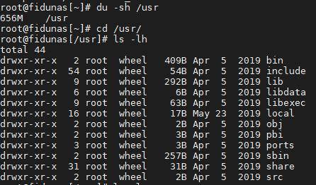

9,700
You might like to use du -sh /usr (as an example) to find the size of each of the directories in the root of your install, then dig in with each path to get to the big volume of data.
People would usually use /root as one of the locations that catch files by accident.

ejecuta el comando y esto es lo que aparece
E ingrese esa carpeta y eso me parece, pero bueno, me preocupa eliminar algo allí y que el sistema falle.
¿Qué puedo hacer?
9,700
/usr was just one example.
Seems it was only 656 MB, so probably not the issue.
Try /root or other directories in / to see which one has more than 10GB in it.

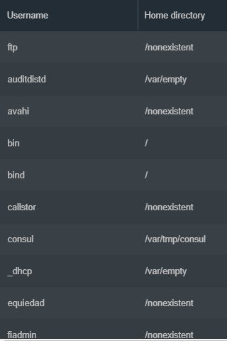

I understand you, and yes, in that location are the logins, but my specific question is, how do I make sure that the logons are no longer stored in the / home folder. If it's a freenass configuration issue, or AD.
9,700
In the GUI, under Accounts | Users... then edit the user to see the home directory location. Change it there if necessary.

But the logins I see correspond to the users of the active directory, not the accounts created from the Freenass GUI
15,504
9,700
Do you see a home directory defined when you edit those users?

OmarNoah
Mar 11, 2020
22
yo see this
und other like this.
/ var / empty
/ var / tmp / cónsul
but anything with the home directory /home
9,700
I can't see anything there that tells me that those users will be using anything from /home.
I can't explain why there's anything in /home at all as I don't know how your users are connecting to and using your FreeNAS server.
Maybe the best option is just to move the data out and keep it in a safe place in case somebody needs it back, then monitor to see if anything else is saved there... check with whichever user saves data there how they are doing that.
