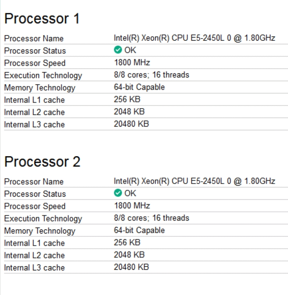

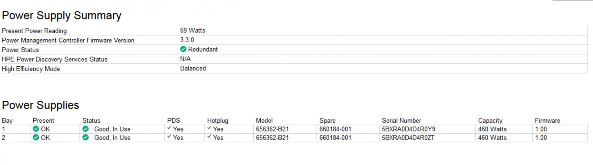

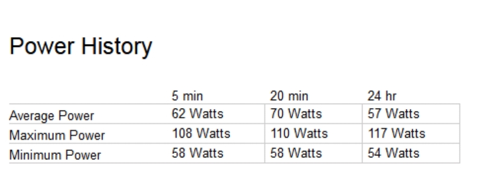

If power consumption is a must, cpus from intel with "L" naming are for you. Like E5-2450L. On intel site it says 70w tdp. Funny is that my g8 with 2 x 2450L consumes 67w at the wall, al 3 of them.
If you are ok with 120-180w / hour, you can go for a dell R720 12 bay model.
HP will consume less then Dell at the same config and specs.
Each drive you will put in the server is 5w at the wall, so 50w will be only the drives, beside the server.
You could go with dell t20, hp ml 30.
