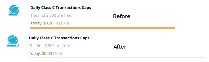

Need to modify /usr/local/lib/python3.6/site-packages/middlewared/plugins/backup.py as referenced by this post... https://forums.freenas.org/index.php?threads/modifying-a-py-file-in-freenas.60017/ to add the option of --fast-list to B2 Backup but my very entry level python skills are not up to the task so have no idea what to add where.
Without the option we hit the class C transaction CAP rather quickly with a once a day backup of ~500GB and its quite costly at ~ $73/month (relatively costly as with the --fast-list option we never even come close to the cap and it costs $5/month).

really appreciate the help, gave me an idea of where to start... what I ended up doing was hitting the manual "Run Now" option in Freenas Cloudsyncs area then quickly doing a ps ax | grep rclone to read the command line that Freenas was using which btw is...
/usr/local/bin/rclone --config /tmp/tmpiq8gbaxl -v --stats 1s sync /mnt/Basin/Storage/Main remote:Helios/Main

/usr/local/bin/rclone --config /root/myRclone.conf -v --stats 1s --fast-list --transfers 16 sync /mnt/Basin/Storage/Main remote:Helios/Main

So after adding the --fast-list option for me it has made a HUGE difference, went from 93,670 Class C transaction for a single backup of 500GB to 165 Class C transactions for the same backup.
