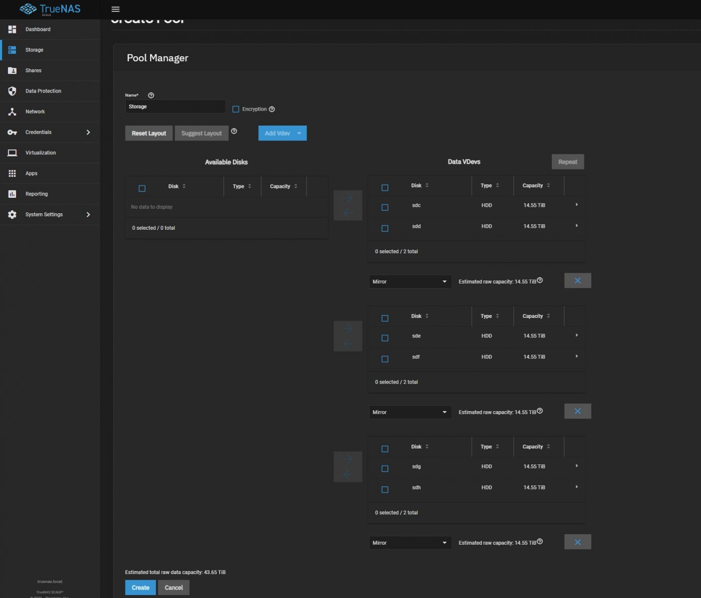

Hey, thanks for the reply. Is this what you were referring to? Would this give performance similar to striped drives? thank you!
artlessknave
Oct 29, 2016
1,506
a zfs pool is always striped across every vdev.
this will give you 3 striped vdevs, with each vdev being a 2-way mirror.
you can lose any 1 drive, or any 3 drives from *different* vdevs. if 2 drives in the same vdev are lost, the pool dies.
you will also lose 1/2 the space to redundancy.
depending on what you are planning to store, raidz2 can give better performance characteristics AND more storage, as well as better overall redundancy (a raidz2 of 6 drives can lose *any* 2 drives).
RAIDZ2 generally performs more poorly, with one notable exception. Because a RAIDZ2 is typically composed of a large number of drives, 6-12, it may be able to outrun a similar mirror pool on write speeds.
Mirror vdevs are faster in almost every other way. Because each vdev is independent of the others, you have a much larger number of simultaneous IOPS that can be processed -- for example, with a 12 drive pool, and six two-way mirrors, you can be doing six separate write operations to different disk regions simultaneously, or twelve read operations to different disk regions (because each side of a mirror can be servicing different read requests). The same vdev in a RAIDZ2 configuration is limited to a single operation at a time, or possibly two or three if the operations happen to be on very small blocks.
Not really true. While it is true that RAIDZ2 is more redundant than a mirror pair, it is important to remember that three-way mirrors are definitely a thing, and give you the ability to lose up to two drives in any vdev. In a 12 disk pool, this really does mean that there is a scenario where you can lose EIGHT drives and still not lose the pool, but of course one component in each vdev needs to survive. But of course you only get 1/3rd the raw space.
To the OP:
In general, while ZFS has some similarities to conventional RAID levels, there are also some significant differences. It may be a better idea to describe what your workload is, and get some more specific advice as to what would work best.
RAIDZ is optimized towards large sequentially accessed files and a small number of simultaneous users (ideally just one). They give you great space efficiency and redundancy options including RAIDZ3.
Mirrors are optimized towards random access and large numbers of simultaneous access. You actually do not get the full advantage of mirror pools until you have several (/many?) simultaneous accesses going on. It is also somewhat easier to grow the size of a mirror pool for various pool and vdev composition reasons.
We're happy to help educate you if you describe what you want to do.
