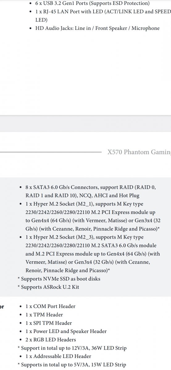

So my am4 motherboard has 8 sata ports and I intend to use them all. 2 m.2 slots, but one of them doesn't work if I use all of my sata. I already have a pcie gen3x4 m.2 expansion card I could use for a cheap boot drive. Just wondering if TrueNAS will work properly booting off of a cheap ssd in the gen3x4 card, and I can leave the gen4 1tb in the gen4 motherboard m.2 slot?
I'm pretty sure that only the SATA line is shared, and you can use the M.2 slots for NVMe while keeping all SATA ports.

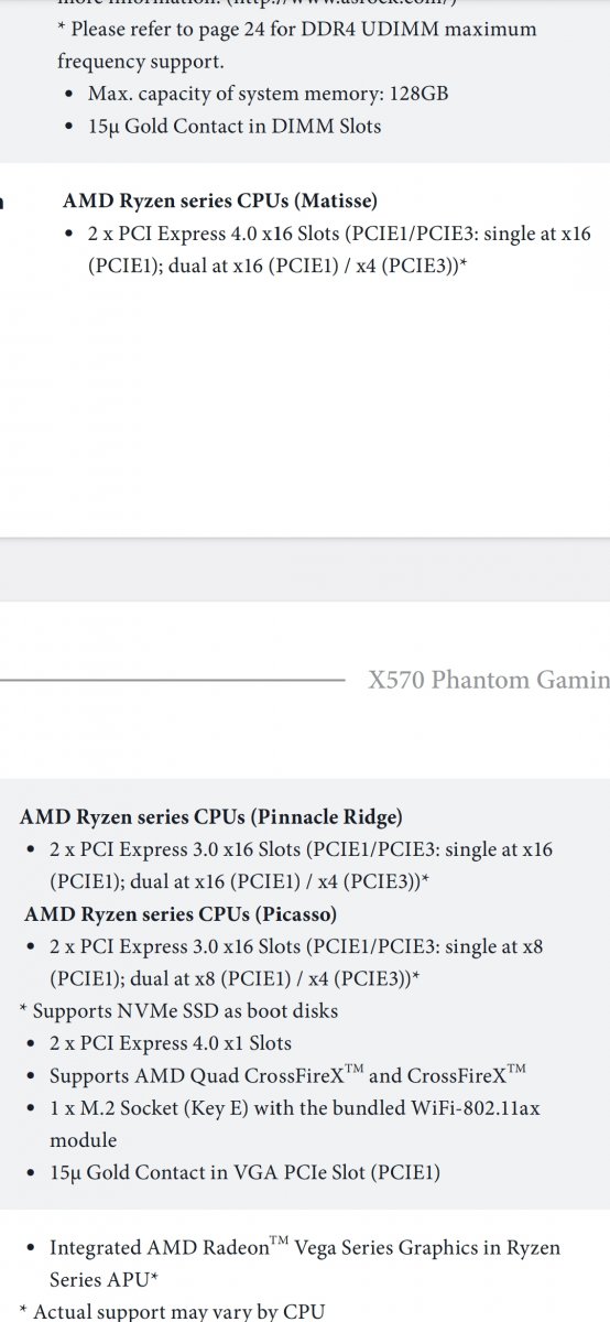

Ok thanks. I was able to find a new gen3 128gb nvme on Amazon for $15 from a cheap brand, but it at least has a 5 yr warranty. I'm 99% sure that my PCIe3 slot supports nvme boot disks, according to the manual. Maybe I don't even need the card, and both nvme and all 8 sata, will work simultaneously. The language they use in that part or motherboard manuals is always a bit confusing to me. My am5 asrock board, has a complete diagram or how everything connects to the chipset and cpu, but this am4 board doesn't. I guess the best thing I can do is just test it.

I've always had a hard time interpreting exactly what they mean in MB manuals, where they talk about m.2 slots and sata. The CPU is a 5600G (Cezanne), so I guess both m.2 slots will be limited to gen3, which is fine. Where I'm confused is when it describes Hyper m.2 socket (M2_3). Does it just mean that it supports m.2 sata drives and m.2 nvme drives? So I can use all 8 sata and both m.2 slots?

It seems clear that "M2_3" can do either SATA or NVMe / PCIe, depending on the M.2 module. With a NVMe / PCIe M.2 device installed, the SATA port, (if shared), can be used by the SATA connector.
So you should be good to go.
We have seen some people accidentally buy M.2 SATA devices not understanding the difference. This has led to disabling a SATA port on the system board, like you are trying to avoid. (Or accidentally buying a M.2 NVMe device, on a M.2 SATA only slot...)
This is one of the things I find quite annoying with the M.2 standard. They tried to make it an all in one standard. The old mSATA / mPCIe standard was pretty straight forward. But the M.2 standard includes so many variations, in size AND interfaces supported, that it is confusing.

Having a block diagram in the manual is further benefit of server board, beside ECC support and IPMI ;)
AM4 systems are especially horrible in this respect, due to the number of CPU architectures with different PCIe capacities which could go in there.
But in this case, and for this M.2 slot it seems that there's not even a shared line (or the small print is hidden elsewhere).
