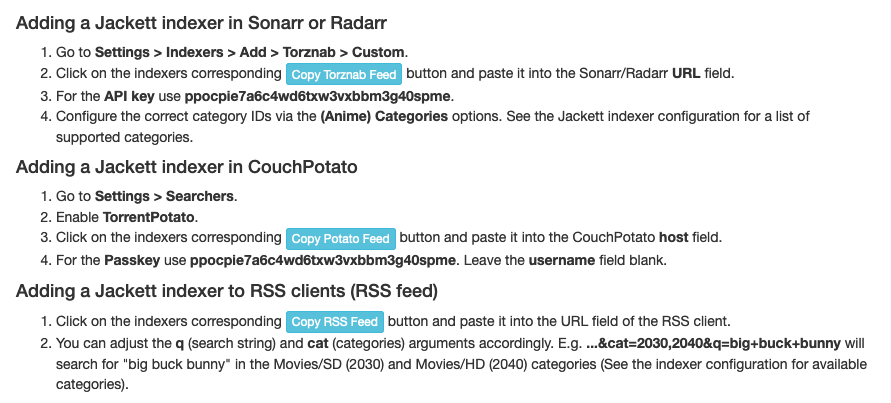

Every where. Jackett has documentation for installation on FreeBSD considering this thread was created to help people install prowlarr suggests that your mistaken about prowlarr having better docs than jackett. Please note i am also including third party docs such as blogs, tutorials etc.. in this. Also at the time of my comment ye did not have documentation for custom indexer while jackett did. These are just a few things i searched for. The was many more things i was searching for documentation on that i could not find and had to figure out. If you have custom use cases for jackett/prowlarr you will find far more information regarding jackett than you will with prowlarr. This is more than likely due to jackett being around a lot longer. Im sure in time prowlarr will have documentation on par with jackett.
Third party guides are maintained and created by the community - be the change you wish to see.
Prowlarr does of course have a quickstart guide on the wiki.
This quickstart guides are more targeted at arr users. For jackett there is a lot more documentation for people using custom application/use cases and if its not in the documentation then you will be able to find it on blogs, reddit etc.. Again im sure this will change in time.
Again, not sure where or what gave you that impression. Prowlarr provides a newznab or torznab endpoint for every indexer. This is the same that Jackett does (with Prowlarr supporting usenet as well) [This is also on the wiki](https://wiki.servarr.com/prowlarr/indexers#viewing-an-indexer-id-or-url)
I dont think that docs is anywhere on par with what jackett have or what you can find on jackett. Again there was a reason this thread was created. There is step by step in jackett on how to get torznab, rss feeds etc...
