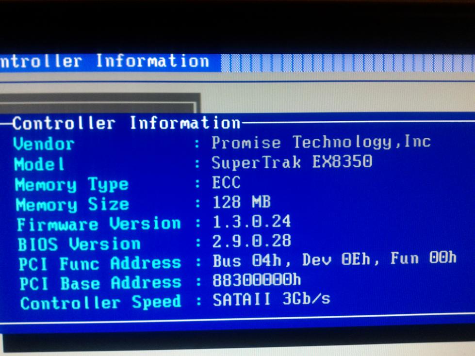

I have the SupeTrak EX8350 and have tried a couple of different things to get it to work but no luck. I installed ubuntu server 12.04 and it recognized the card with no hassle so that means it can work in a Linux environment. So it she be able to work with freenas. If anybody knows how to get this working please chime in.
Linux and Unix are not the same, very different. UNIX is like the great-great-great-great grandfather of Linux. Just because it works on Linux doesn't mean it works on Unix (FreeNAS/FreeBSD).
You can try a FreeBSD 8.2/8.3 boot CD/DVD and if it works with that, THEN it's possible to make it work with FreeNAS.

Just installed FreeNAS-8.2.0-RC1-x64 (r11876)
No luck with the hdd showing up I found freebsd driver on a website but not sure if they'll work

Don't mess with trying to find a driver, just find a FreeBSD 8.2 or 8.3 live boot CD or DVD, boot up FreeBSD, and see if your controller works. Drivers don't work the same on FreeBSD as Linux. If you can get it to work with one of those specific versions of FreeBSD, then we can figure out the next step.

ugen1.8: <Corsair> at usbus1
umass0: <Corsair Voyager, class 0/0, rev 2.00/11.00, addr 8> on usbus1
ugen0.2: <Cypress Semiconductor> at usbus0
ahcich7: Poll timeout on slot 0 port 0
ahcich7: is 00000000 cs 00000001 ss 00000000 rs 00000001 tfd 50 serr 00000000 cmd 10000006
ada0 at ahcich0 bus 0 scbus0 target 0 lun 0
ada0: <OCZ-NOCTI 2.25> ATA-8 SATA 2.x device
ada0: 300.000MB/s transfers (SATA 2.x, UDMA6, PIO 8192bytes)
ada0: Command Queueing enabled
ada0: 57241MB (117231408 512 byte sectors: 16H 63S/T 16383C)
ada1 at ahcich8 bus 0 scbus8 target 0 lun 0
ada1: <WDC WD20EARX-00PASB0 51.0AB51> ATA-8 SATA 3.x device
ada1: 600.000MB/s transfers (SATA 3.x, UDMA6, PIO 8192bytes)
ada1: Command Queueing enabled
ada1: 1907729MB (3907029168 512 byte sectors: 16H 63S/T 16383C)
ada2 at ahcich9 bus 0 scbus9 target 0 lun 0
ada2: <WDC WD20EARX-00PASB0 51.0AB51> ATA-8 SATA 3.x device
ada2: 600.000MB/s transfers (SATA 3.x, UDMA6, PIO 8192bytes)
ada2: Command Queueing enabled
ada2: 1907729MB (3907029168 512 byte sectors: 16H 63S/T 16383C)
ada3 at ahcich10 bus 0 scbus10 target 0 lun 0
ada3: <WDC WD20EARX-00PASB0 51.0AB51> ATA-8 SATA 3.x device
ada3: 600.000MB/s transfers (SATA 3.x, UDMA6, PIO 8192bytes)
ada3: Command Queueing enabled
ada3: 1907729MB (3907029168 512 byte sectors: 16H 63S/T 16383C)
ada4 at ahcich11 bus 0 scbus11 target 0 lun 0
ada4: <WDC WD20EARX-00PASB0 51.0AB51> ATA-8 SATA 3.x device
ada4: 600.000MB/s transfers (SATA 3.x, UDMA6, PIO 8192bytes)
ada4: Command Queueing enabled
ada4: 1907729MB (3907029168 512 byte sectors: 16H 63S/T 16383C)
ada5 at ahcich12 bus 0 scbus12 target 0 lun 0
ada5: <WDC WD20EARX-00PASB0 51.0AB51> ATA-8 SATA 3.x device
ada5: 600.000MB/s transfers (SATA 3.x, UDMA6, PIO 8192bytes)
ada5: Command Queueing enabled
ada5: 1907729MB (3907029168 512 byte sectors: 16H 63S/T 16383C)
ada6 at ahcich13 bus 0 scbus13 target 0 lun 0
ada6: <WDC WD20EARX-00PASB0 51.0AB51> ATA-8 SATA 3.x device
ada6: 600.000MB/s transfers (SATA 3.x, UDMA6, PIO 8192bytes)
ada6: Command Queueing enabled
ada6: 1907729MB (3907029168 512 byte sectors: 16H 63S/T 16383C)
da0 at umass-sim0 bus 0 scbus14 target 0 lun 0
da0: <Corsair Voyager 1100> Removable Direct Access SCSI-0 device SMP: AP CPU #2 Launched!
da0: 40.000MB/s transfers
SMP: AP CPU #1 Launched!
da0: 3824MB (7831552 512 byte sectors: 255H 63S/T 487C)
SMP: AP CPU #3 Launched!
GEOM: da0s1: geometry does not match label (16h,63s != 255h,63s).
GEOM: da0s2: geometry does not match label (16h,63s != 255h,63s).
Trying to mount root from ufs:/dev/ufs/FreeNASs1a
ZFS filesystem version 5
ZFS storage pool version 28
Going to search for some spare drives...
TheSmoker
Sep 19, 2012
225
Card not being detected, driver not loaded. Probably PCI_ID has to be added to sources so that the OS will identify the card and properly load the module ...
pci2: <mass storage, RAID> at device 14.0 (no driver attached)
pcib2@pci0:1:0:0:       class=0x060400 card=0x00000000 chip=0x03708086 rev=0x00 hdr=0x01
