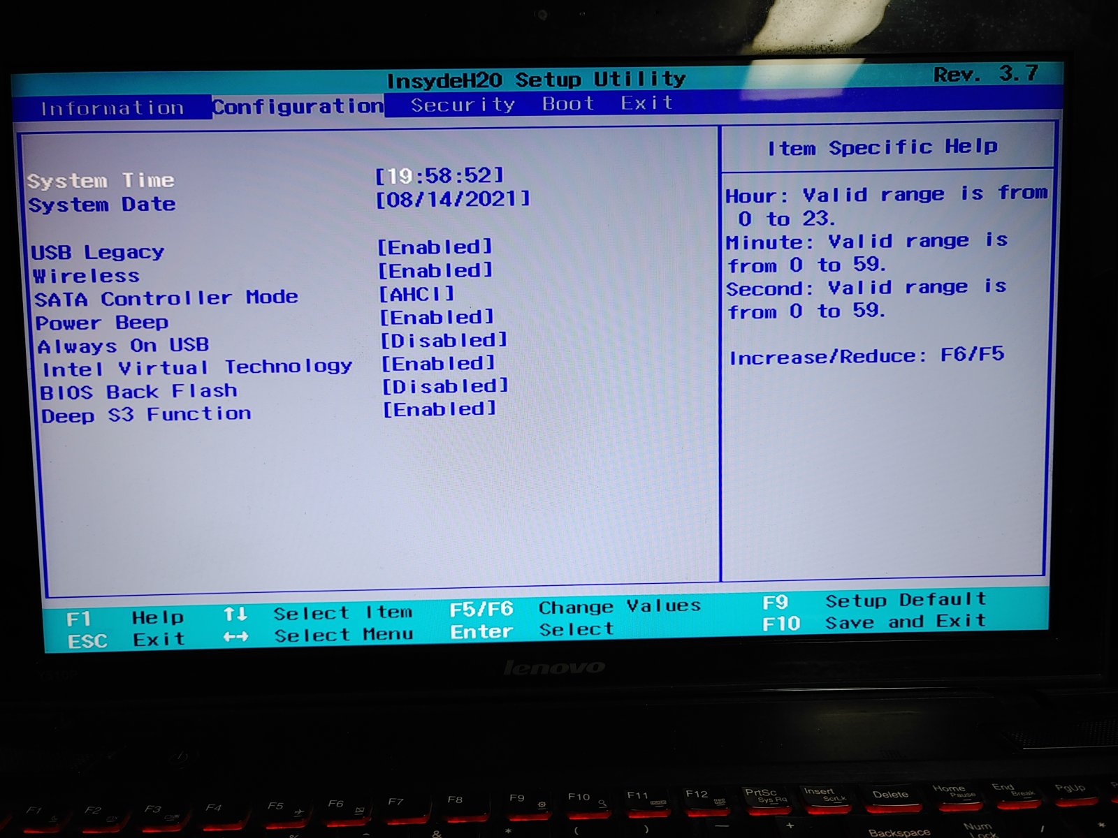

As I mentioned in my earlier reply, there's no such option on this bios. As well, proof of this claim, here is a picture of the Configuration menu in the bios,

9,700
Since "Deep S3 Function" is a sleep mode (that's enabled), perhaps you want to look at changing that.
I did not realize that S3 was a sleep mode. An internet search reveals to me that it saves power when the system is not plugged into AC power. Which is not the case - the laptop is always plugged into AC power. Additionally, the M2 wifi card from this laptop has been removed; its connected to the network via the ethernet jack.
Still, no harm in disabling that setting. Will do so now. In addition to the `systemctl` command I just ran, it will (hopefully) keep the device network-accessible.
