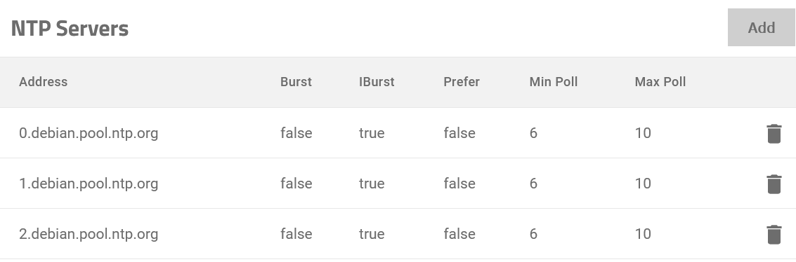

Here are my NTP servers:

The good news is I found the problem: Wrong date throws off SSL which causes everything to complain.
