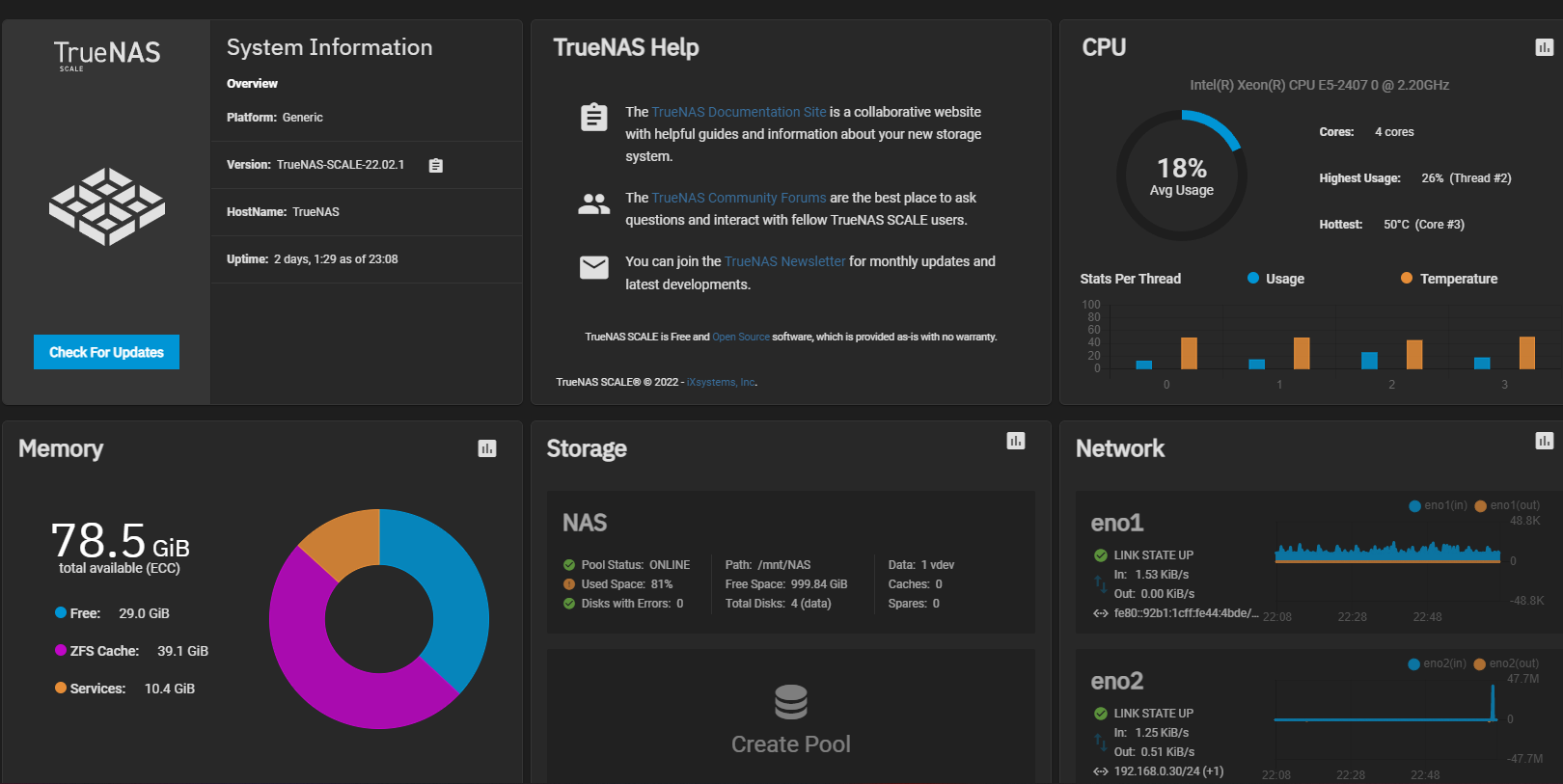

I was able to deploy Portainer 2.13.1 on SCALE, however deploying apps through Portainer appears to be extremely slow as well as using the apps, does anyone have same issue? my CPU usage and memory very low.
truecharts
Aug 19, 2021
788
To be clear: SCALE Apps cannot in any way, shape or form be deployed through portainer.
