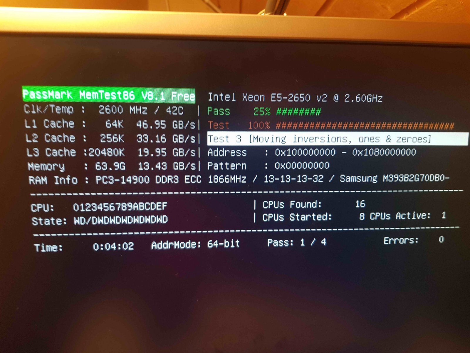

ok
so i have run memtest many times now
i found broken ECC and got then changed so now i dont get any errors when running paralell or sequentian test
but Round Robin crashes / freezes the server so i have to power cycle it
what is wrong ?
i have testet dual cpu and single cpu and it is the same problem no matter how i combo the cpu's and Dimms
and it freezes the same place every time

i found broken ECC and got then changed so now i don't get any errors when running paralell or sequentian test
How did you make these pass when they use to fail?
I will cut to the chase here, this is not the proper forum to troubleshoot your motherboard hardware. I'm fine helping you but there are websites that specifically deal with hardware issues, specifically overclocker websites. I use to do a lot of this when CPUs were running in the MHz ranges and RAM was much slower just to squeeze a few more MHZ of speed out to the system. My first change was from 4.7MHz to 12MHz, that was over double the speed! In the day that was a big thing.
1. You may have faulty RAM.
2. You may have a faulty CPU.
3. You may have a faulty Motherboard.
4. You may have dirty power.
5. Your system components may not be able to run at the speed/voltage you are providing.
How do you troubleshoot something like this, well painfully slowly. You can do this anyway you desire but here is how I'd do it:
Each item below is to be tried and then you run the test that failed. If the test passes then you keep running the testing for at least 2 more days non-stop. You must prove that you fixed it and it wasn't a lucky pass.
1. If you have a spare power supply, replace it.
2. Find out what speeds and voltages your RAM supports and what your motherboard is running it at. According to the screen shot you are running at 1866 MHz, manually set the BIOS to run the RAM at 1600 MHz and run your testing again. Typically the voltage of the RAM will automatically drop a little as well, it depends on the RAM really. Do not manually adjust the voltage settings unless you know the risks!!!
3. Underclock your CPU or change the CPU voltages in BIOS. This is not for the faint of heart!!! You can easily destroy your CPU or motherboard voltage regulators. You make changes on .01 VDC increments (depending on your motherboard). Do a Google search for "overclocker RAM failure CPU" or something similar, they can give you advice but you will need to do a lot of reading as well.
So if you do not have a spare power supply, you can safely do #2 and underclock to 1600 MHz.
Good Luck!
