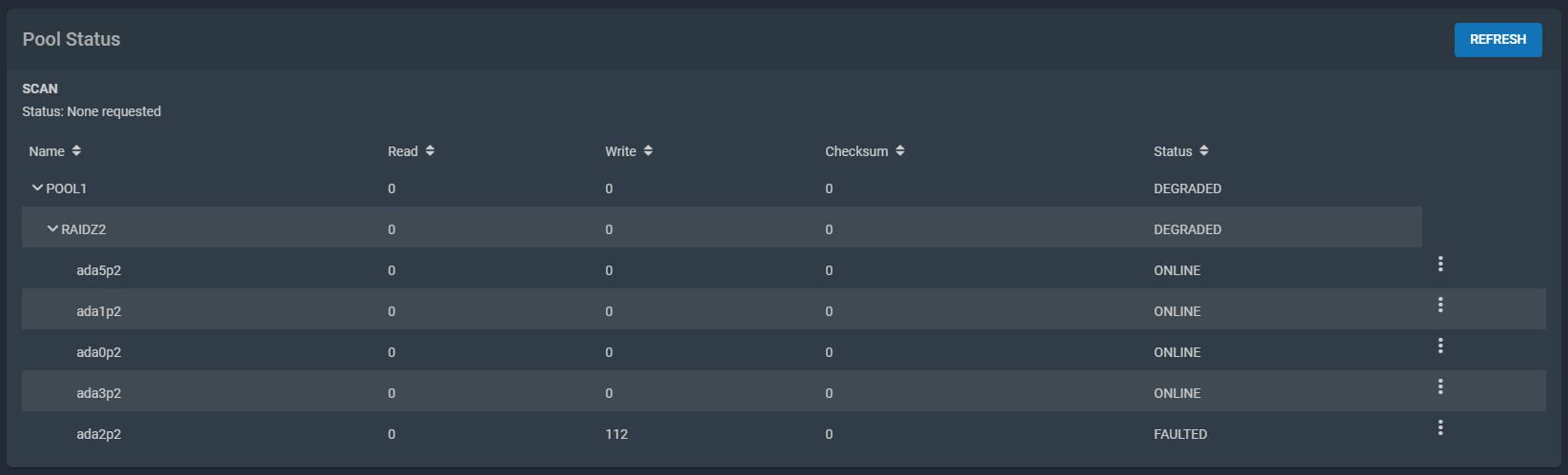

  • When I go into Storage / Pools page, pool 1 is showing yellow triangle with label "DEGRADED". No explanation as to why.
  • If I click on the little wheel icon and select "Status", it gives me table of drives with one of them having Status of "FAULTED".
  • The table on this page is weird. It's showing all zeros in all columns, except the affected drive which as "Write" value of 112. No idea what this means.

Here is the mentioned pool status table. I don't really get what I'm looking at here. The pool has 1.5TB of data on it, so I don't understand why Write column is showing zeros.
Zero write errors. Or 112 write errors for ada2.
Can I find out what is wrong with the FAULTED drive, that is see why it was faulted?
Write errors, as per above.

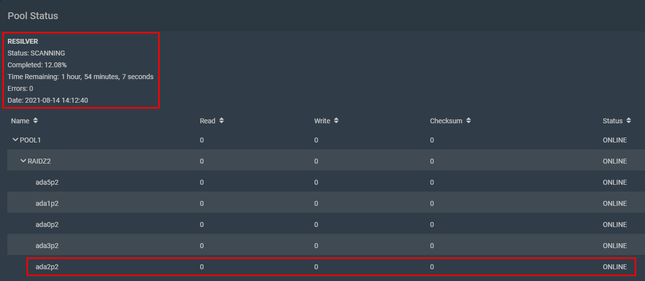

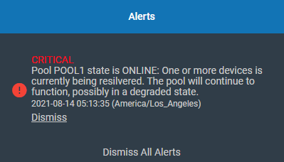

I restarted the thing and affected disk started showing as "Offline". When I tried to turn it "Online" out of curiosity, it would show "Faulted". If I then again click the option to send it "Offline", it would show "Offline" state immediately. I have shut the PC down and replaced cable for the affected disk. Then I started the PC up, waited for TrueNAS to boot and went into POOL1 status page. The disk was shown as "Offline". I clicked the three dot menu and selected "Online" option. The disk immediately went into "Online" state and dashboard was showing all green. I watched it for a moment and I noticed there was a bell notification after a moment:
I wasn't sure what was happening and thought maybe during replacing the cable I caused issue with another disk, so I went into Storage view:

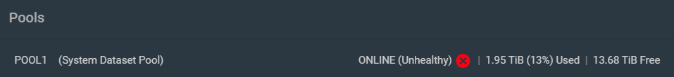

I was wandering about for a moment there, because nothing would tell me why the pool is unhealthy or what that means (lost redundancy? lost data? For example, unhealthy state in Storage Spaces for Windows means completely lost array with data being unrecoverable, MSDN page for this state actually says the data needs to be recovered from a backup and there's no recovery of the pool possible). Eventually I noticed on pool status page, the UI was telling me a drive was being resilvered:
Somehow I was able to get into this view, but I don't remember how I did that:
I'll wait for TrueNAS to finish it's thing and see if data was lost or not. Please feel free to let me know if there was anything wrong with my approach.
