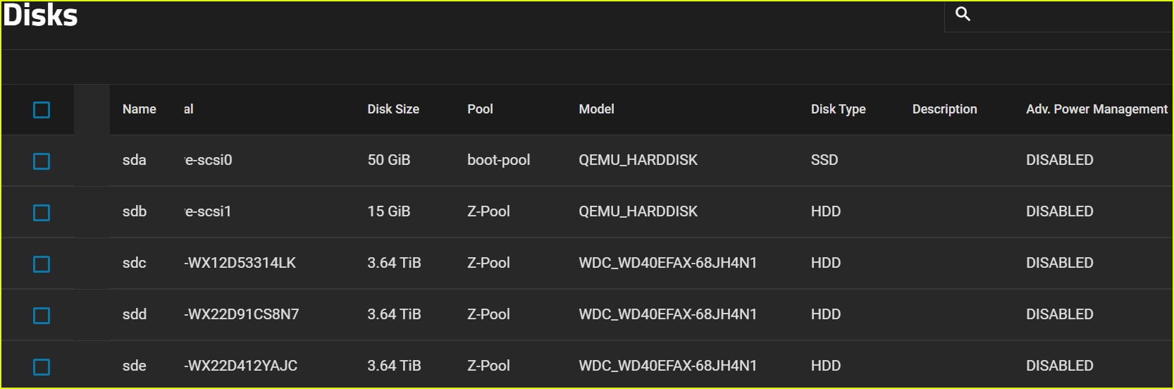

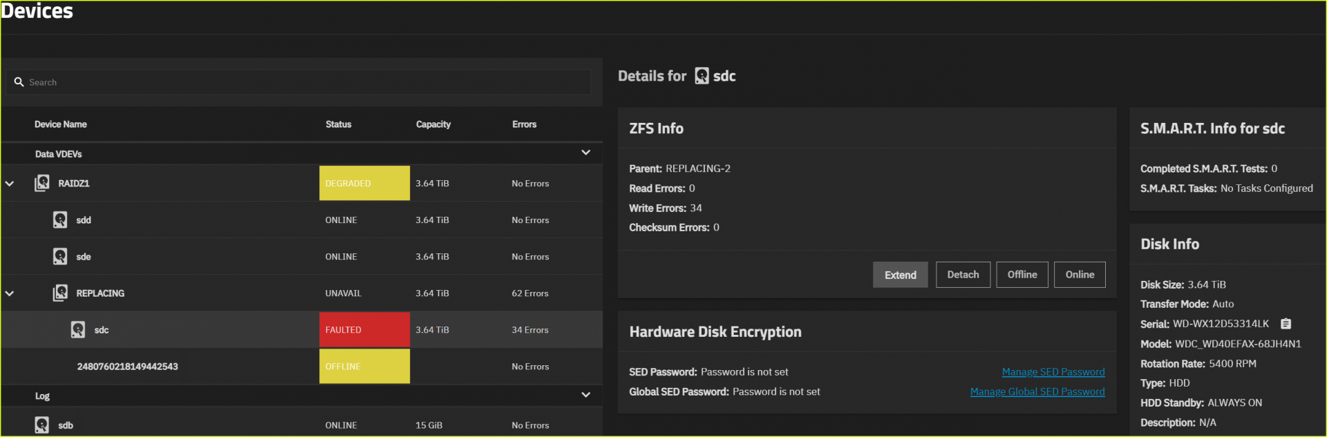

Hi everyone,
I use the latest version: TrueNAS-SCALE-22.12.4.2. A few days ago I noticed that the pool got degraded due to errors on a WD disk. I ordered a brand new WD disk same model, and replaced the old one following web directions.
I don't know, maybe I did something wrong, but now the status of my pool is degraded, saying REPLACING see below....
I'm not expert in Shell commands, I thought I can operate the NAS using the GUI, but now I am totally confused.
I don't think this is something very difficult to solve... the pools is functional although degraded, datasets are OK. Last SCRUB didn't find any errors.
Could you guys help me with this.? Please.
What should I do now?
Thanks a lot
Titus
# zpool status -x
all polls are healthy
# zpool status
pool: Z-Pool
state: DEGRADED
scan: scrub repaired 0B in 03:37:25 with 0 errors on Sat Oct 21 14:37:27 2023
config:
NAME STATE READ WRITE CKSUM
Z-Pool DEGRADED 0 0 0
raidz1-0 DEGRADED 0 0 0
221e12ae-18cc-4ba9-b8bb-dc900a78a185 ONLINE 0 0 0
1613cb3c-b16b-400c-8522-cfd16ad3a679 ONLINE 0 0 0
replacing-2 UNAVAIL 0 0 62 insufficient replicas
7ec5cb4b-f45d-404d-b353-983ec843df05 OFFLINE 0 0 0
2dc3d0fb-2284-42ea-bdb0-618daec0d544 FAULTED 0 34 0 too many errors
logs
e308f94e-52dc-46bd-9f32-81aff23148e0 ONLINE 0 0 0
errors: No known data errors
pool: boot-pool
state: ONLINE
scan: scrub repaired 0B in 00:02:06 with 0 errors on Thu Oct 19 03:47:08 2023
config:
boot-pool ONLINE 0 0 0
sda3 ONLINE 0 0 0
