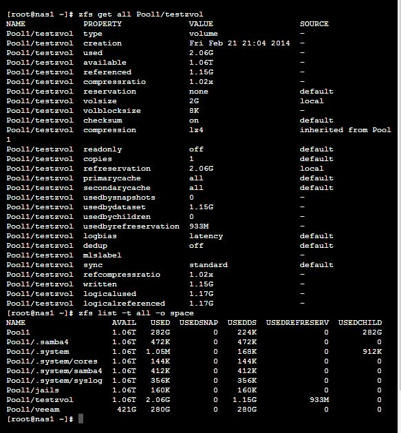

Ok, so I did a test and am seeing the same results as you...I do have a little bit different setup though and will perform another test tomorrow that mimics your setup.
Setup > Current Pool used space = 280 GB. Created a 2GB zvol and used as iSCSI device extent. Pool used space is now 282GB. zvol has lz4 compression and no dedupe. Filled the LUN from a VMware ESXi 5.5 host to near max capacity. Deleted all of the files and filled the LUN again. I did this about 5 times and each time it was about 1.2GB worth of data. The entire time my pool used space remained at 282GB. This tells me that the dirty blocks were reused. The used space of the zvol never decreased though (USEDDS field), so it definitely doesn't unmap the unused blocks when the files are deleted by the ESXi host, but it does reuse them.
I'll test a file extent tomorrow.
