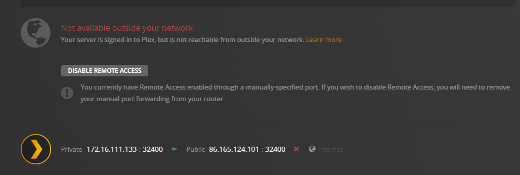

Hey guys.

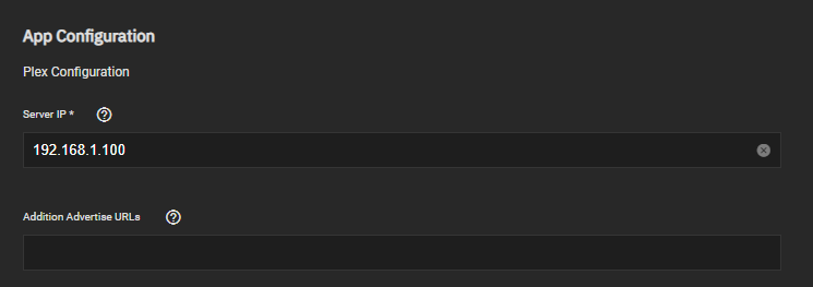

Curious issue. I have my Plex Apps Node IP set to 192.168.1.100, furthermore in my TrueCharts Plex App settings, I have set the Plex Server IP to 192.168.1.100
However inside the Plex app, the Remote Access is pointing to the incorrect IP of 172.16.111.133 for my local address (private) , as per the below image.
Is there another way to adjust it so that Plex so far as the remote access is using the local IP of 192.168.1.100 as all my port forwarding is set to that IP. Never had this issue where Plex has decided to go against the Node IP/Server IP settings before.
Any help appreciated.

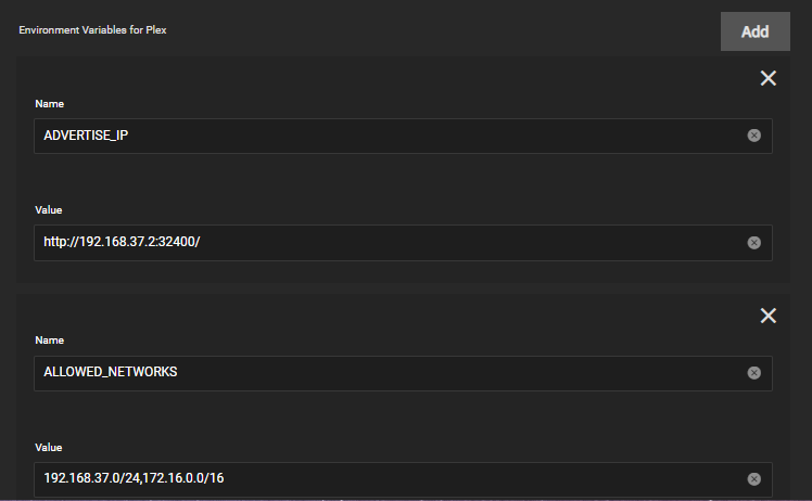

Also the Advertise_IP variable is set
Aslo set in the Plex app and still no remote connection without first opening the port manually on my router even though it
supports UPnP and other devices are making use of it.

The example seems to not have the trailing slash as you do, but that's a long shot.
MadMungo
Jul 18, 2015
13
I just saw that, but in the bridged network example it has the trailing slash. Will have to wait till tomorrow to remove it and see if it
changes the behaviour.

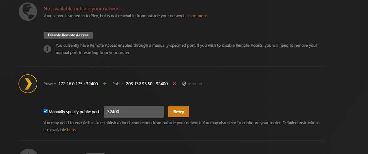

I'm sorry to bring up this old topic, but I'm having this problem right now.
I set the IP as indicated by mr fr34ky but it doesn't work.
