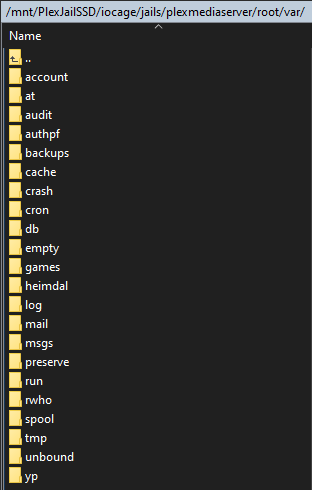

Does anyone know Plex's metadata cache location when installed in an iocage?
Looking at the specified paths on Plex's own support site (https://support.plex.tv/articles/202915258-where-is-the-plex-media-server-data-directory-located/), both the pre 11.2 and post 11.2 directories don't contain my cache.
Curious if you guys know where to find it.

It depends. Based on the Plex version you're using, it looks like you haven't used the plugin method to install Plex. If you've used a resource on the forum to install Plex, it's likely Plex metadata was moved from its default location. Try the following:
  1. Shell into the jail
  2. Use sysrc -a to dump a list of non-default configuration variables.
  3. See what the variable plexmediaserver_plexpass_support_path points to.
